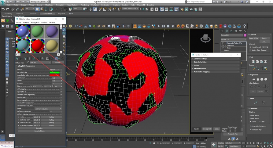

      I created a very simple scene with two spheres, one of them is with noise modifier just to make the VRayDirt texture visible:
      Click image for larger version  Name:	3dsmax_2017-05-25_12-17-17.jpg Views:	1 Size:	170.8 KB ID:	953447
      I baked the sphere without the VRayDirt material with Projection Mapping with source the sphere with VRayDirt texture and I got the following results:
      Dirt disabled:
      Dirt enabled:
      Dirt enabled / consider same object only:
      As you can see the dirt is no longer projected when Consider Same Object is active.

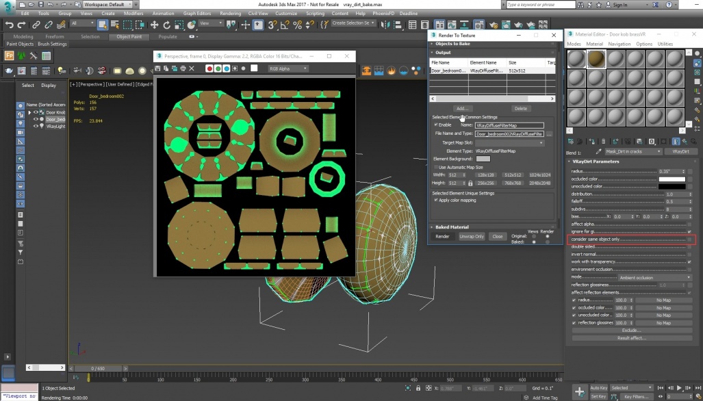

            Look like I replied too fast, the issue has nothing to do with the V-Ray Dirt material and I can confirm that Consider Same Object option works just fine.
            This is how the bake looks like when Consider Same Object is disabled:
            Click image for larger version  Name:	3dsmax_2017-05-31_16-51-57.jpg Views:	1 Size:	203.3 KB ID:	954180

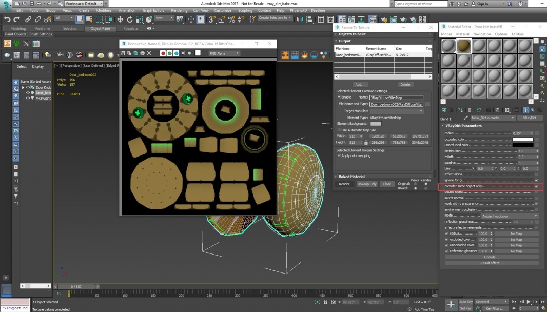

            .. and here how it looks like when it is enabled:
            Click image for larger version  Name:	2017-05-31_16-54-35.jpg Views:	1 Size:	208.6 KB ID:	954181
            As you can see the Dirt(green color) on the second image is not influenced by the low-poly geometry as it was on the first image.
            The real issue here is that V-Ray doesn't make the geometry being projected onto invisible for the camera and V-Ray sees it and render it.
