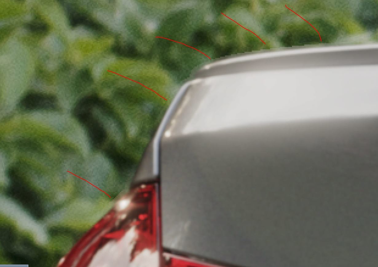

Lens Effects causing edge artifacts with background image enabled in VFB
I don't think that Lens Effects are optimized to work with Background Image yet.
From what I can see Lens Effects are not applied to the background image, instead the image overrides them and this might cause that artifacts.
In my tests I couldn't replicate that exactly but I think it happens cause Lens doesn't know how to blend the effect between the render and the Background image.
Will add a note about that into our system.
If possible, please send that part of the scene for investigation.
