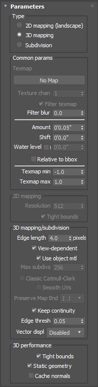

    I was testing some fabric displacements in RT and noticed an issue in the displacement on the seat cushions (attached). I tried adjusting a few things but nothing removed it. When I switched to Advanced, it was gone. Any ideas what is causing this in RT? Just curious if I'm overlooking something. Thanks!

        I found that the issue has something to do with the View-dependent option of the Displacement modifier. Can you try to turn it Off and lower the Edge length to 0.05 which should give you the same quality?

          Yes, switching View-dependent off and lowering the Edge length fixed the issue. Thanks for your help!

            That's great, then you can use this approach as a workaround until we fix this bug with our RT/GPU renderer. Thanks again for providing all the information requested!
