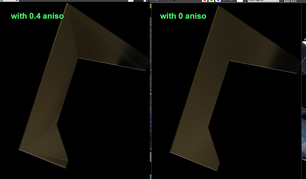

    as in the image, anisotropy is set to 0,4 causing the object to seem to show strange smoothing across the surface. it`s just a spline with an extrude and a radial brushed metal map on reflect map/glossy channel, no bump.
    does anything spring to mind ? is that correct ?

        I tried extrude grid instead of morph and it`s a bit better but still some rather messy bits in certain places and who knows how it`ll react with animation, so it didn`t really fix it. I tried resetting Vray and remaking the material. Knowing me it`s probably something I`m making Vray uncomfortable with !
        I`ll strip it down and send it over or attach it a bit later.
        thanks
        anthonyh
        edit:
        here`s just the object with lights/camera. I tried a default vray material and that seemed alright so maybe it is correct ? it still looks weird like it`s picking up smoothing from the vertex points
        I`ve also created a new object from scratch and before filleting some of the vertices it renders ok, after it just looks weird so it seems it`s related to that.

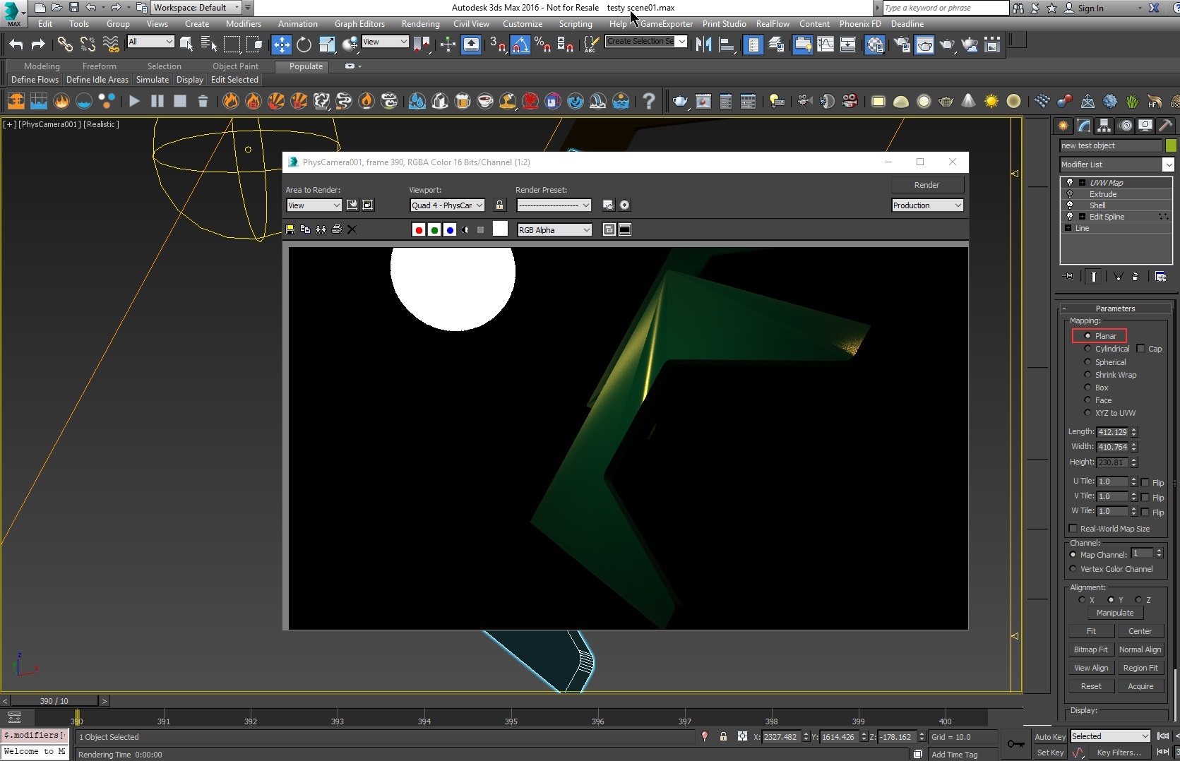

            Thanks for the scene. The problem is that the surface has a planar Map, switch to more appropriate mapping for this object like Box and anisotropy will be handled as expected.

              Hi Svetlozar,
              Ok, I didn`t realise, good to know.
              thanks for checking it out.
