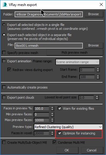

        Probably there are too many proxies or other elements in the scene and it takes lots of time to export/load them.
        If the regular rendering takes the same amount of time then we could expect the same thing from the IPR rendering.
        Have you tried to re-export proxies with Optimize for Instancing enabled?

          I don't think I ever looked at that button. Is it on by default?
            Is there ever a time when you DON'T want that option on? I'm just asking because that seems like one of those things that should just be on by default.

              I'm not sure if this particular option matters for you case, Bobby (yes, it's on by default). Can you get me the vraylog.txt file from your temporary folder right after the render? It may help to figure out where the time is spent.
