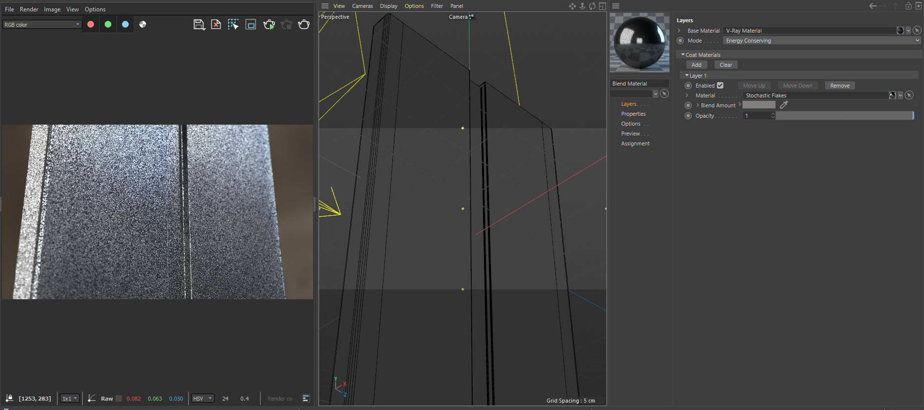

      I would probably approach it with an blend material - base mtl and stochastic flakes on top.
      From there it's all about the base color and the amount of flakes you want
        I have tried but never used it before.. but honestly i don't understand how it works.
        The flakes are too large... and too bright...

          You can tune the flakes aspect from the stochastic shader, you have tons of controls, just check the manual to understand all the parameters
          If that isn't enough you can also use a custom map for simulating the flakes (you can build that easily if needed), you will need a base metal-like shader with a rough surface, then you can add a coat layer for the flakes, insert a B/W map for isolate the individual flakes and a normal map for give them a random inclination so that they'll reflect randomly depending on the ray angle, here is a small sample from a much larger map I've made for my shader collection:

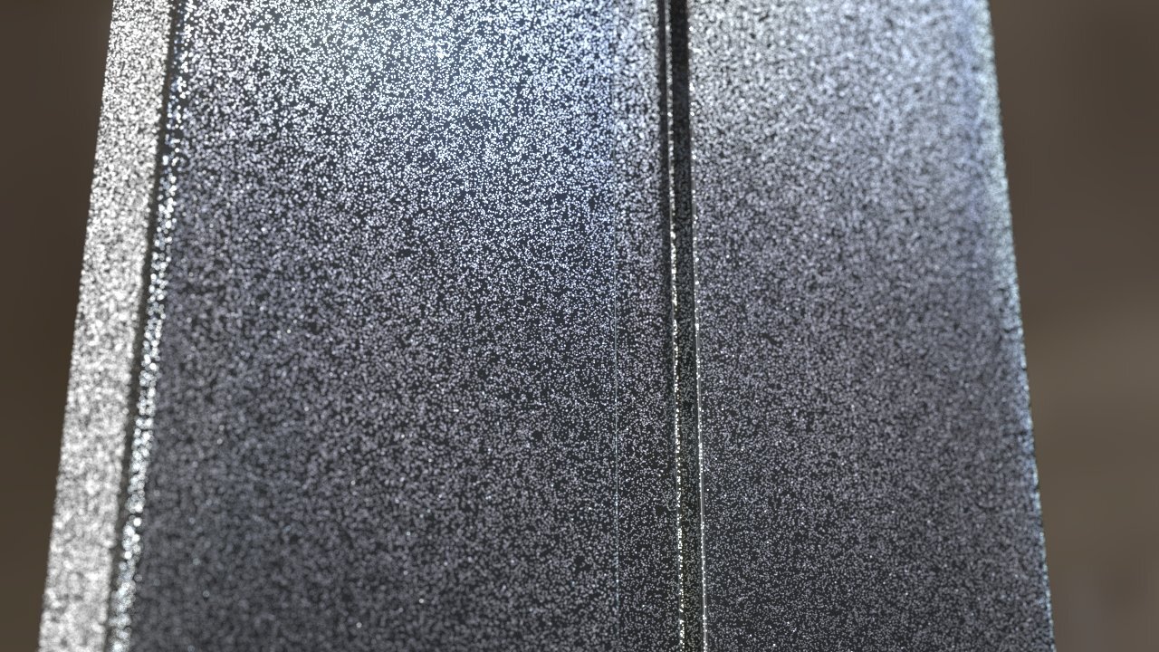

            There aren't many flakes in this material. This is what i have created in the older vray.... not the best but ok....

              I've tested a map-based flake system in a couple shaders of my collection but that was for a very different purpose.
              Here I've done a quick test using a stochastic flakes coating inside a blend shader (I've used one of your image as reference), it can be improved with a bit more work but for a proper setup I'll need a physical sample of the material.
