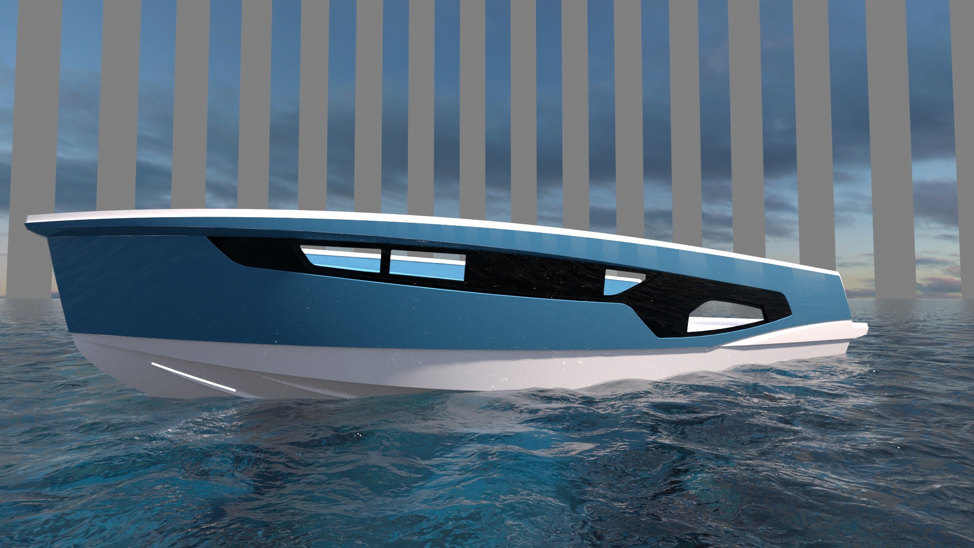

              Same here! Very important to change soon. See pic in the attachment.
                cool water...
                  Thx, but the problem comes up when I change the visibility of the sky. Frame 1 (invisible) and frame 2 (visible).
                  Rendering frame 1+2 computes the issue with the stribes (picture). Rendering just frame 2 is fine.
