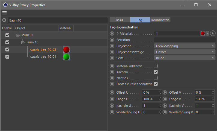

                    Because the proxy manager was not recorded in the video, here is a screenshot. The Error-Msg at the end wasn't recorded either.
                    But this is also an error msg in the console:
                    [0h 0m 44.1s] [WARNING] Duplicate string IDs (_2_309C239931C11502CACF8900DB2C0000) with different generators in uvwgen_ids parameter in material: Baum10_509EE00571B01581@mtl_uvwselect

                    The Proxy only uses the first Texture for rendering.
                    I'am using the latest Build from 20210219
