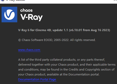

      Please, provide your Cinema version, a screenshot of your V-Ray > Help > About menu as well as your set up.

          We have tested it on different machines and it works as expected. Please, provide your Cinema version as well as a screenshot of your V-Ray > Help > About menu. ​
