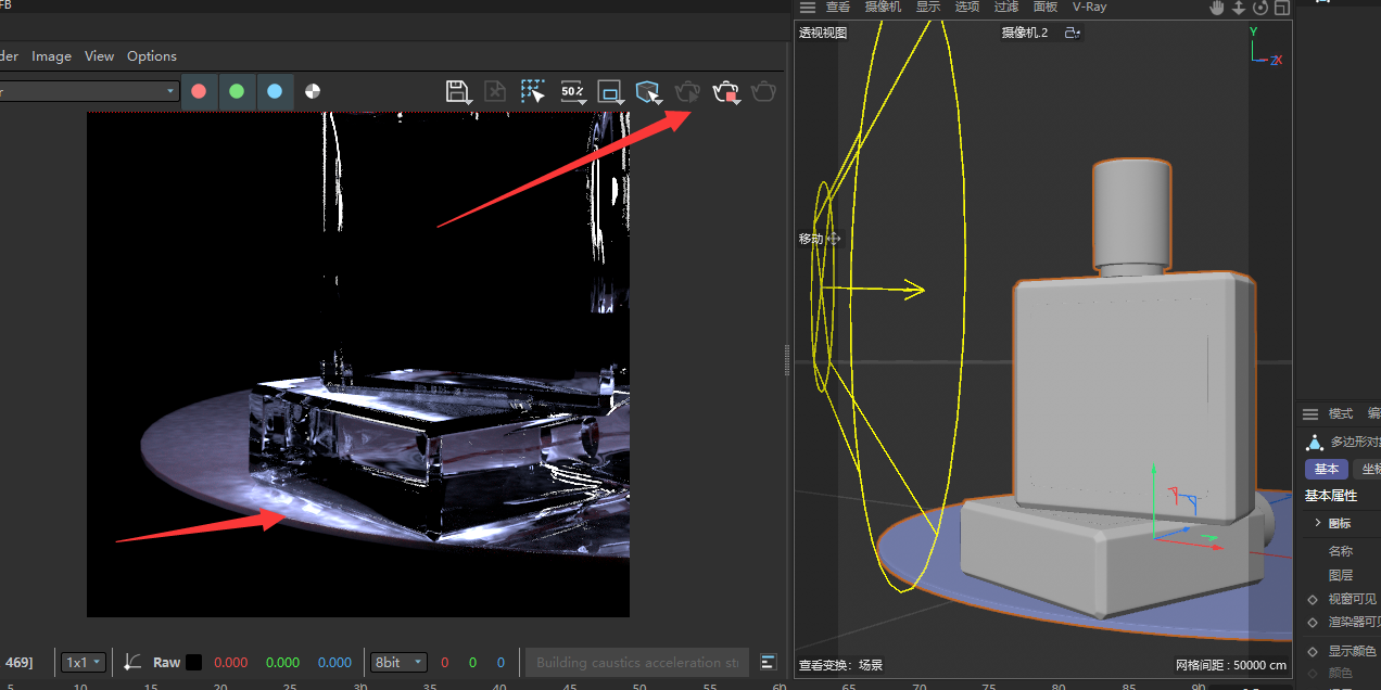

When using GPU mode in VRay7, enabling caustics results in different outcomes for interactive rendering and final rendering
  • When using GPU mode in VRay7, enabling caustics results in different outcomes for interactive rendering and final rendering
ID:	1228169 Click image for larger version
ID:	1228170 Just like in the picture, the brightness of the two rendering modes is different. I uploaded the problematic project
    Nihao,
    Thank you for the question! Enable Light Cache in the interactive option in Render Settings -> VRay -> Interactive -> Shading -> Intaractive tab!
    I guess this will solve the difference.
    Cheers

      I tried this method but it didn't work. You can test the file I uploaded
        Nihao,
        Thank you for the reports! The caustics multiplier is brighter with around 41% in the interactive renderer than in the final in VRay GPU; the issue is logged to our system VGPU -6757. Keep you posted when the development ends, and you can work without flags.
        So as a workaround, you can decrease this amount to get a similar result.
        Cheers,

          Thank you for your notification
            Hi 123456_
            We are looking into this issue now, there will be a fix soon
            I will message you once the fix is ready
            Best,
            Muhammed
