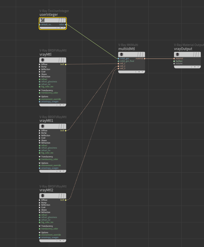

    Yes, I have done in the shader with an integer attrib, so each grp will get let's say an attribute SWT in this case `i@swt = 1;` group1 `i@swt = 2;` group2 and so on, obviously if you make the name of the groups in a smart way you can run a for each and add the i@swt attrib in a wrangle.
    Then in the shading part, you get a userInteger and add the swt attrib and connect a multiid node, then you can plug in each material and the attrb will know where to put the right material.

                Here you go, it's pretty straightforward.
                  Thanks guys, Yes totally agree its pretty straight forward.
                  By me using a copy to points vrs copy. Its still not working as expected. I have the prim data coming out but Vray for some reason either doesn't see it or just not using it.
