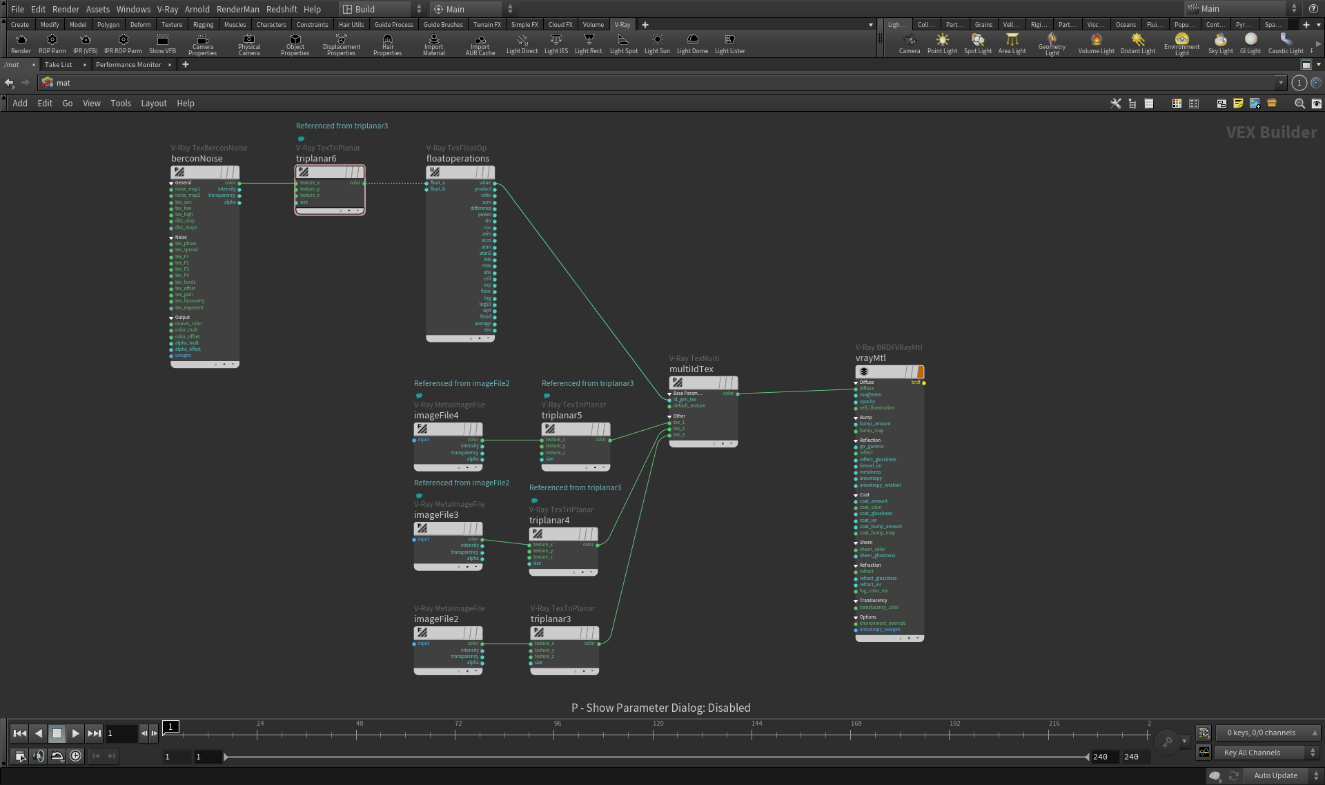

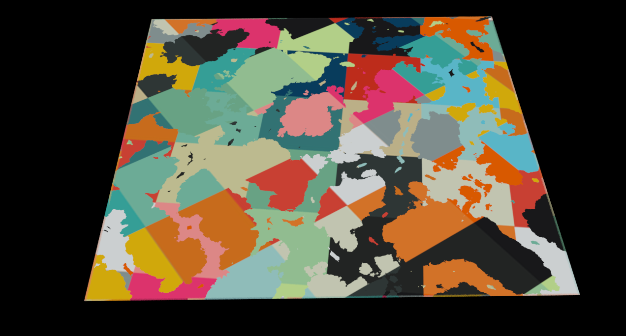

          You could use V-Ray Noise or V-Ray BerconNoise multiplied by number of textures you want to "scatter", connected as "id_gen_tex" in a V-Ray Multi ID Texture.
          Here is a screenshot with textures with triplanar and randomize mappings applied on them. Check if this work for you.
          Click image for larger version  Name:	houdinifx_FN2oMslNqT.png Views:	0 Size:	229.2 KB ID:	1102206 Click image for larger version  Name:	houdinifx_ZtWacJeAaW.png Views:	0 Size:	261.2 KB ID:	1102207

            chakarov that does help with hding the issue and i guess i could just use a 3d noise and a texture blend for that too. Probably good enough for us now.
            though the lines still remain and i guess maybe i should turn it into a feature request.

                chakarov Cant get the texture bombing to work like in the image? How do you have things setup in the multi ID tex node?
                  Hi adrian_camarena , what are your OS, V-Ray build number and Houdini version. Check the example file which I uploading here.
                  Georgy Chakarov | QA
                  www.chaosgroup.com
                  georgy.chakarov@chaosgroup.com
                    Thanks. It seams to be working now. I'm using H18.5.351, windows, and Vray 5 official release. So how does it choose which texture to use? Is it based on different value ranges and the Vray texfloat op is just to gain the image up and down?
                      The BerconNoise texture generates values between 0 and 1, so I use TexFloatOperations to multiply the noise to number of textures which I want to "mix".
                      www.chaosgroup.com
