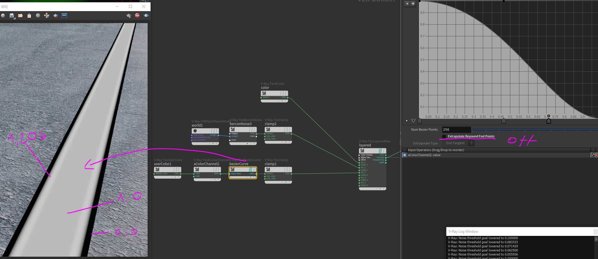

I'm having some issues with the curve node during IPR rendering and setting maps to debug mode.
VFH: 4.30.03 from 2020-07-07
The value outputs from the curve are wrong.
Starting with a simple gradient that ranges from 0.0 to 1.0;
Applying a curve adjustment to it gives you over 1.0 values on values that weremid gray before, curve clamp is ON (extrapolate off);

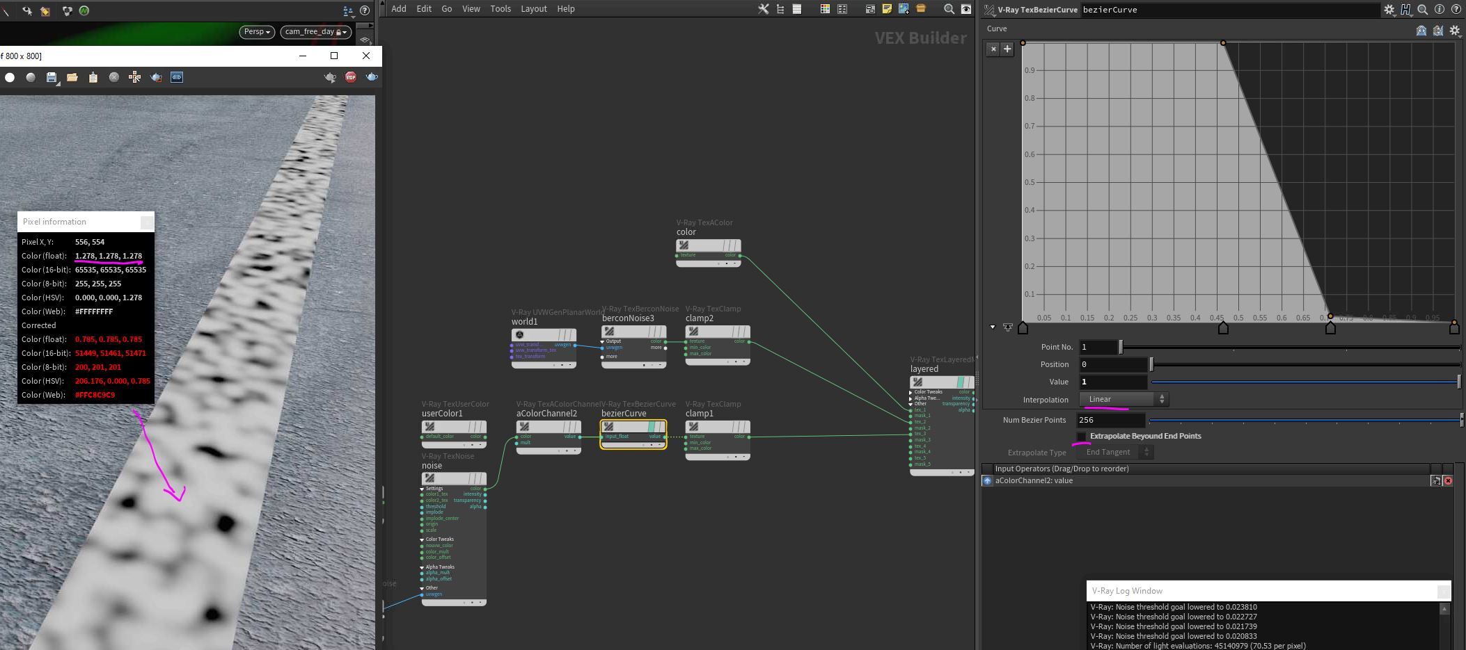

This also happens on other inputs, here with a noise;
Also happens if the curve is linear;
This is an issue and should not happen. Makes it really hard to use the debug mode to build your maps/shaders.
