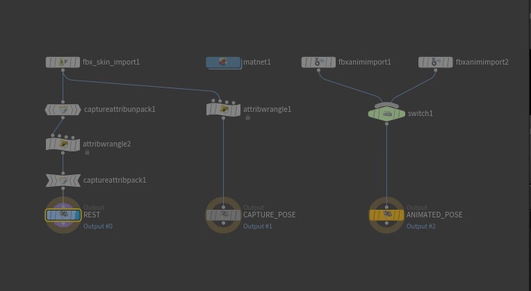

Could you help me understand why my character renders with what looks like tons of spheres?
  • Could you help me understand why my character renders with what looks like tons of spheres?
    I'm using kinefx fbx character import and i convert the principled shader to a vraymaterialbuilder, then I get a really strange render like my character is covered in thousands of spheres. Could anyon point me in the right direction?
    These are points - when vray sees points that are not part of a mesh, it renders them as spheres. Check your geometry
      Hey, thanks for the tip. This is an FBX that renders fine with Mantra and imports and renders into Maya, UE4, Blender etc etc and renders no problems. Just my mesh and skeleton. What points do you think it could be?
      Is it possible this is just a KineFX FBXCharacterImport + Vray issue?
        I'd have to see the scene to tell exactly, but I guess you'd be better off only sending the character mesh for rendering - split it off from the rest after you're done with the animation, and send that to render.

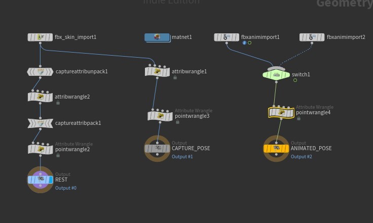

          I sometimes have issues with free floating points that render as spheres. A quick (and bit hacky) fix for that is to through a pscale attribute with 0 on the mesh. points will still be there, but they are scaled to 0 so you will not see them.
                Could you post what that node network or vex might look like? Sorry I'm still fairly new to Houdini
                  just add a point wrangle under you potentially problematic geo and enter: f@pscale=0;
                    Thnx, I tried it everywhere but it didn't fix the issue

                        Set this to "no point rendering" from default "render unconnected points".
                          Thanks for the tip! what node is that?
                          From your image it looks like it is about to say (Mantra) lol : )
                          edit: found it in the Geo Render tab

                            You can also use and "add" sop and use the option "Remove Unused Points" in the Polygons tab to remove any points that are not part of primitives and clean up your mesh so that doesn't happen again.

                              Hey David, actually I did try that many times. It doesn't work in this instance for some reason! Hope i'm wrong, but pretty sure.
