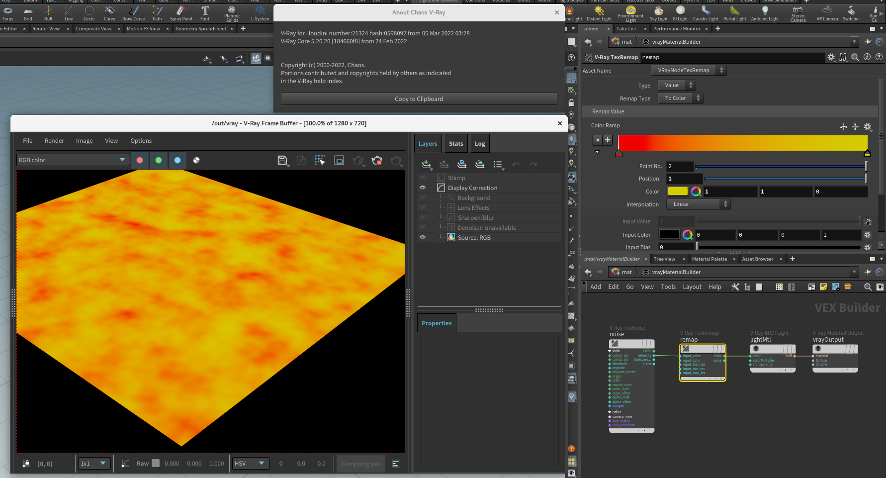

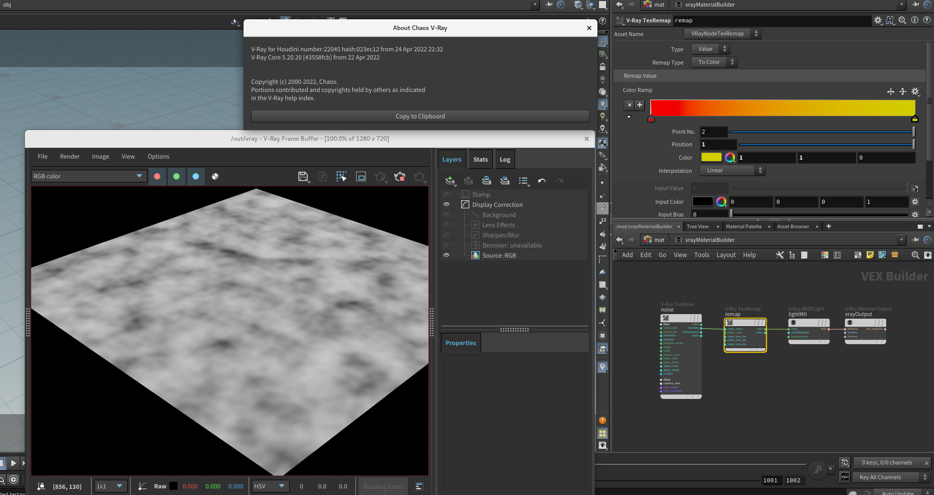

      Hi bdancer
      Unsure which thread I should be posting this in now and I am starting to lose overview a bit but we have downloaded the following build “52020”, “023ec12” and now colour ramps are broken which again means I can't use the build.
      Did you want me to use a specific build?
      See screenshots below. A grid, a noise, feeding into a float to colour remap. Expected result is colourful.
      See network as well as vray version on the two screenshots.
      Hip file also provided but probably not necessary.
