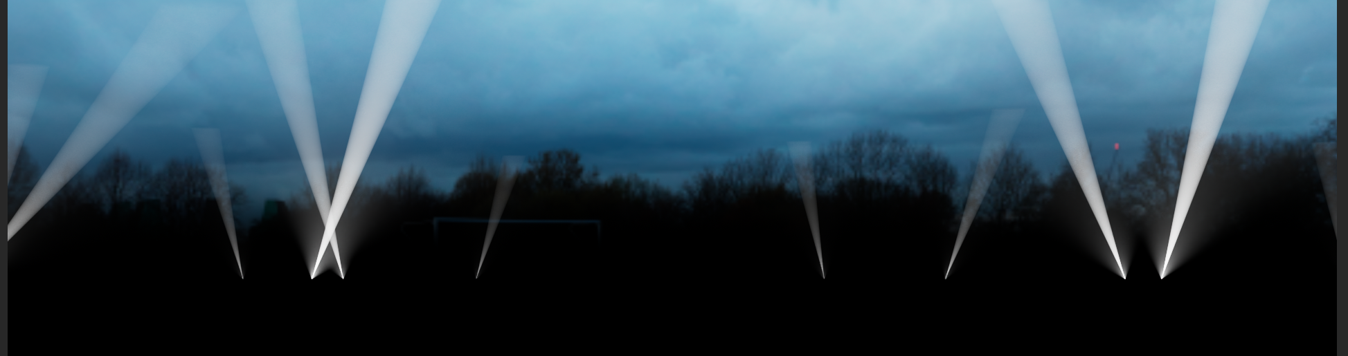

    Hi, so I have a scene with a bunch of spotlights and Vray Fog. Some spotlights behave properly and appear as white light cones in the fog whereas some others seem to have some kind of issue as they are black (see screenshot) I have disabled shadows on the spotlights as this was originally causing this problem on all of them.
    However now it seems to be an issue with only a few and it is always different spotlights that have this issue when I restart Houdini. ​ ​​

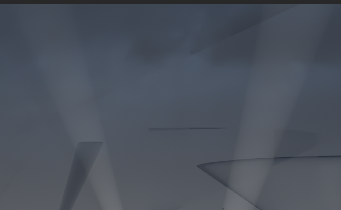

        After doing some testing it appears the problem is the combination of Spotlights and a Dome light that are affected by the Fog. When I set the Fog to "selected lights" and select all my Spots it works as expected.
        (1st screenshot: "selected Lights" without the dome light. 2nd Screenshot: "all lights"​​
