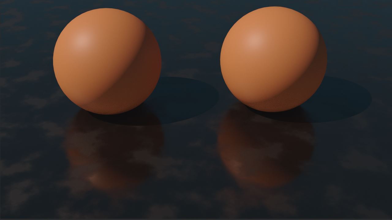

    Hi,
    Would be great to have a AOV that would give us masks of reflections for selected objects, like a multimatte but for reflections.
    See example in attached scene.
    Beauty:
    Reflection mask AOV desired output:

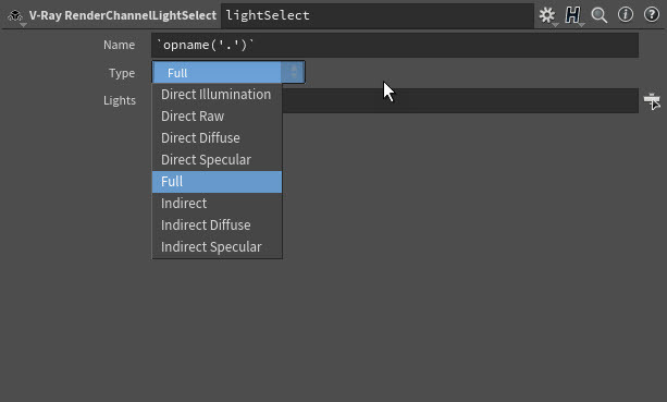

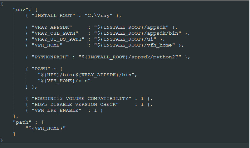

                  Hi
                  I've set the variable VFH_LPE_ENABLE=1. but where can I find Light Select Type menu?
                  Can you post a snapshot?
                  Thanks

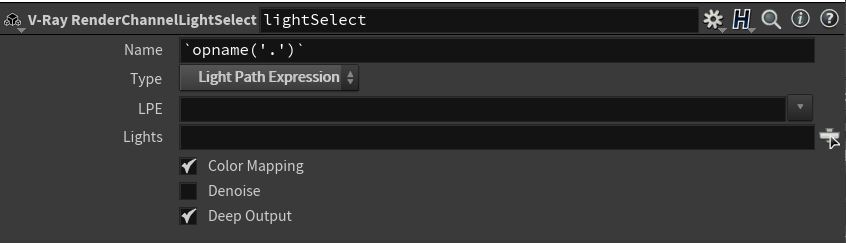

                    Hey elrachyd ,
                    the change was made on Friday, September 11th - it seems the last available nightly build is from Thursday, September 10th. I apologize if my post came across confusing - future builds will use the VFH_LPE_ENABLED variable and you will find a new menu entry under the Type parameter of the Light select element.
                    Hope that helps!

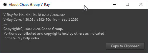

                        Hi
                        I don't have it as you can see
                        • #13
                          Build "from Sep 1 2020" doesn't have this variable support, you'll have to install more recent nightly.
                          andrei.izrantcev@chaos.com
                          Support Request
                          • #14
                            I downloaded the latest one but it show from Sep 1 2020
                            • #15
                              can you confirm please?
