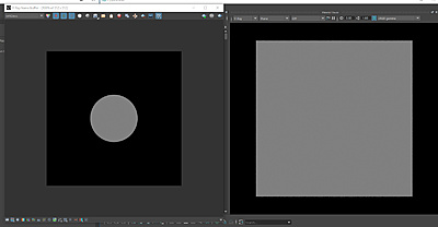

    Hi, so im yet again a little confused by the results in the VFB of the raw reflection and reflection gloss elements with regards to colorspace.
    So I'm.using the default maya 2018 and its color management and im rendering with 'dont affect colors, only adaptation'. With the display image in sRGB button 'on'.
    If im using a texture for the reflection, gloss and bump etc...do I either, need to have maya colorspace set to raw, or add the vray texture input gamma node and set to linear?
    Also is the sRGB button not meant to affect these render elements?
    The reason i ask is because I usually adjust my reflections/gloss maps using the remap node, and use the maya material viewer to visualise it, but when i render, the vfb render element doesnt match unless i add the texture input node.
    (see screenshot)
    First image is with no texture input node. (note how the vfb sRGB button is on)
    Click image for larger version  Name:	vfb.jpg Views:	1 Size:	122.1 KB ID:	1016823
    Second image is with texture input node set to linear (note how the sRGB is off)
    Now i know the maya material viewer has the sRGB button set to on, but i suppose im expecting if the VFB has it on too, they should match?
    thanks
    e: info@adriandenne.com
    w: www.adriandenne.com

      thanks for reply, yeah this was a fresh scene with a 50% grey jpg assigned to the diffuse, reflection and gloss. Yeah i can get them to match by turning off the sRGB in the material viewer as you mentioned...just seemed odd to have to do that.

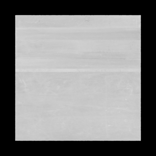

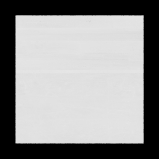

                    Im not sure if i've been caught out with this being another issue and I could be getting confused thinking the discrepancy was in the vfb when it might be in fact, this issue instead...
                    Basically im getting different results when i render with vray, when i have a textures 'alpha as luminance' ticked on or off. Im pretty sure i reported this a while ago. Anyway to test you can either :-
                    1. Connect the alpha of a texture to the glossiness slot of a vray material and toggle the alpha is luminance.
                    2. Connect the alpha of a texture to a blendColor node and assign to any materials color (vray, lambert) etc.
                    If you render the last one with Maya software there is no difference between the 2, render with vray and there is...(see images)
ID:	1017483Click image for larger version
                    Thanks from a very confused person.
                        What type of texture do you connect there? Is it a procedural texture or a file node? If it's a file node, what's the format?
                        What are we looking at with the images? The beauty? A render element? Which one?
                        And what about the remap node - I didn't get this part at all.

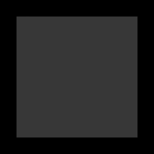

                        • #13
                          Sorry was getting a little exasperated as im sure i posted about the issues with the remap before....anyyyyway..
                          So firstly. Ive added the VRAY_VFB_COLOR_CORRECT_ALL=1 to my maya.env file.
                          Secondly I've attached a scene.
                          So I have a 50% grey JPG mapped to the glossiness slot of a vraymtl. The first image is the glossiness render element when the 'alpha is luminance' is off, the second is when its on.
ID:	1017591Click image for larger version
                          Also, if you use the remap function in the texture node, regardless of the 'alpha is luminance' setting you get the same as the second image. To clarify, my point with the previous post, was that if you render in maya software, the images seem to be fine. (i used the blendcolor to allow me to use the alpha channel of texture only)
                          So im just trying to figure out if this is whats expected to happen?
                          This is with latest vray 3.6 nightly.
                          Much appreciated.
