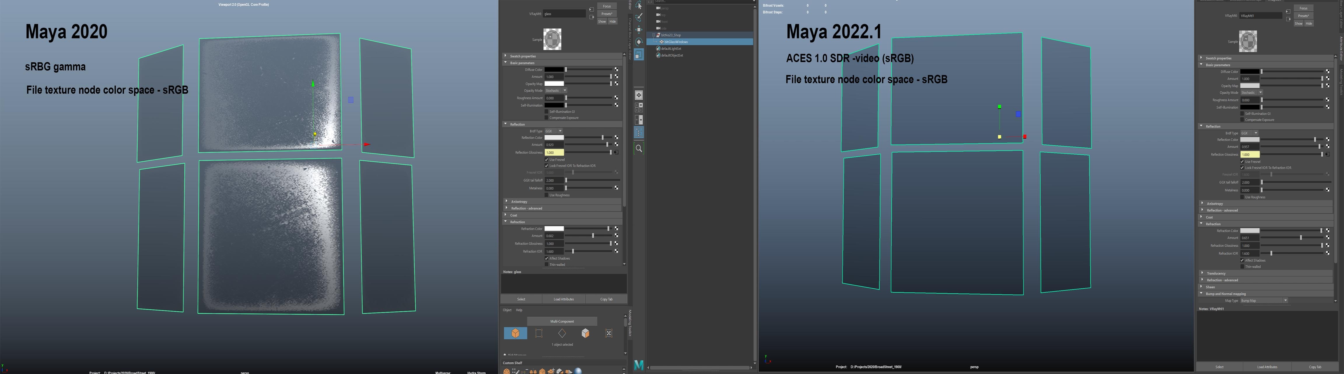

    Hi folks.
    Can anyone help with this issue I have.
    I think it's to do with ACES in Maya 2022.
    If I plugin a texture node to the reflective glossiness I cant get the same effect I had in Maya 2020.
    I use a map to get some simple roughness in the corners of my window, I have modelled 60 buildings so far in Maya 2020 and the workflow works and renders just great. But now in Maya 2022.1 I just cant get the same effect in the viewport or in the render. I'm using latest nightly build on win64.
    Thanks for any help.

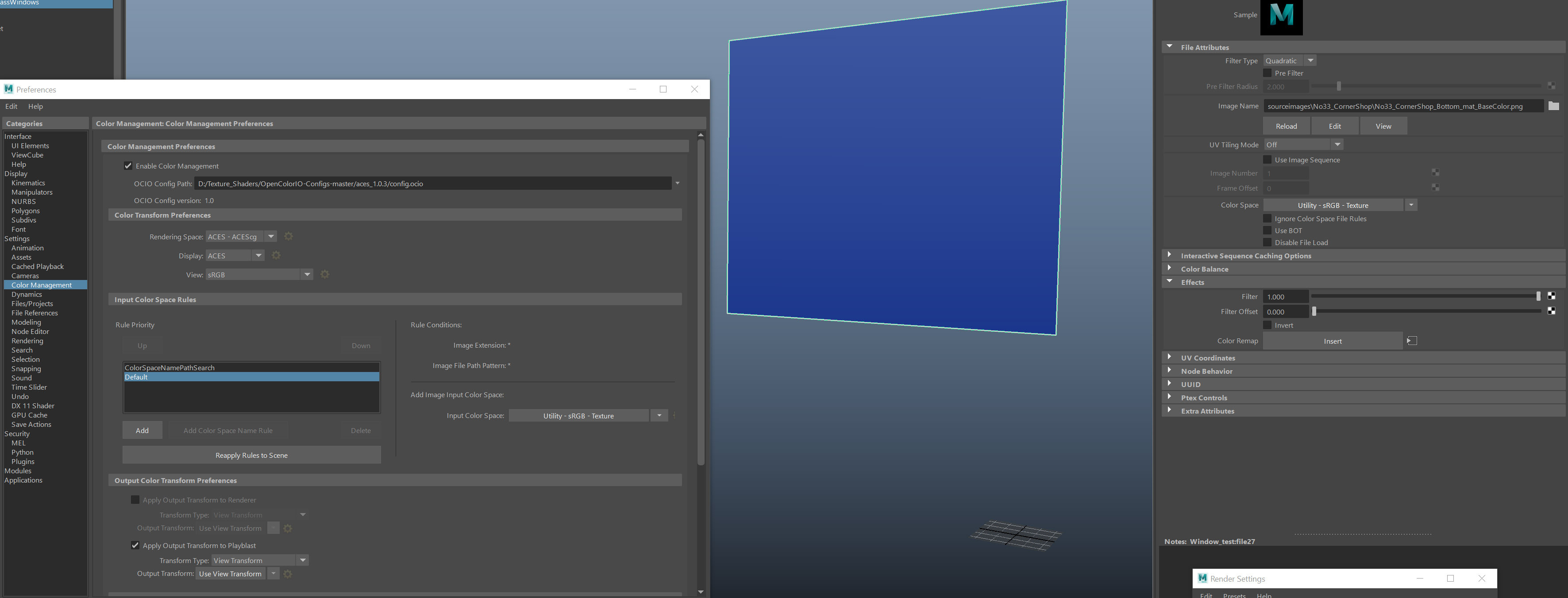

        Hi Seq, can I ask what your viewport color management is set to in Maya 2022?
        I can only get it to work in Maya 2022 if the viewport is set to "sRGB gamma (legacy)". by opening a Maya 2020 scene file it switches to legacy.
        I have Maya colour management set to "aces_1.0.3/config.ocio" with input color space set to "Utility - sRGB - Texture.

            Seems to work fine on my end as well regardless of the set color space. Does it happen in every scene? Just in case - is the "Textured" viewport preview (shortcut 6) option checked?
              Well I managed to get it working. The exported images from Substance Painter "RGB 8bit png's" was causing the issue. I converted them to jpeg and it worked. strange!
