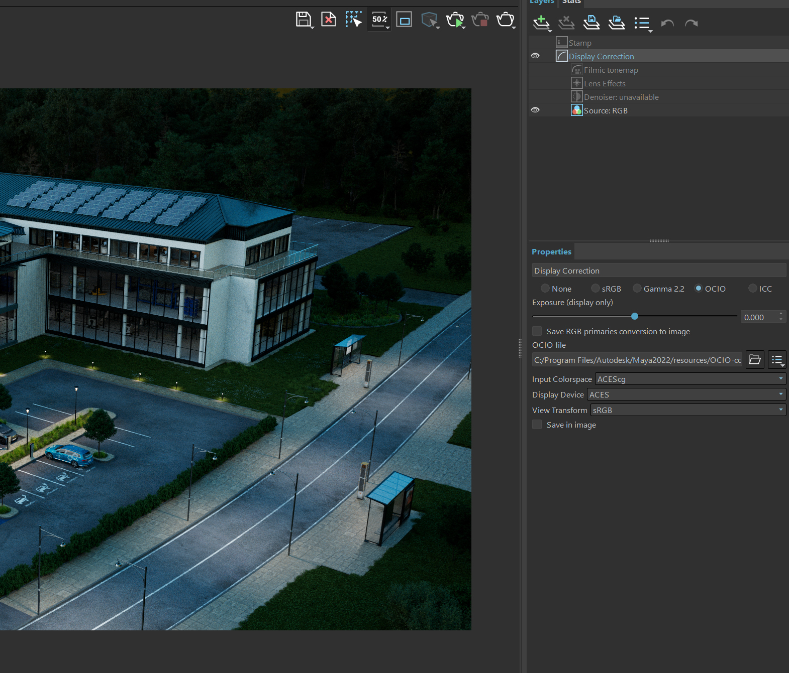

    Hi Guys,
    I am having a bunch of problem with using acescg.
    First i am confused if i have to convert my srgb textures in nuke or photoshop or maya already does that convertion when i put the texture in the right color space?
    For example:
    For Color texture i am using: SRGB colour space
    Should i use acesg for colour texture?Our should i convert this in nuke?
    For roughness and bump i am using: Raw
    Should i use other colour space?
    My is looking really saturated when i put the display correction in ocio with the config.ocio as the same that is plugged in maya color manager.

    For starters, the easiest way to set up ACEScg with Vray and Maya is to set it up in the "Color Management" tab in Maya's preferences. There, you can point to the ACEScg 1.2 OCIO config file on your computer, set the rendering space to ACEScg, and the view transform to sRGB. If you do this, then you don't need to change any other render settings (you DO need to set up the Frame Buffer though, see below) or worry about the color profiles of textures. Just make sure that any textures that aren't diffuse/albedo are set to RAW as you mentioned above. That's basically it.
    In order to see the correct results in the Vray Frame Buffer, you have to set it up. From your screenshot, you are ALMOST there - you have to change the "Display Device" to ACES, and the "View Transform" to sRGB. I would also turn off the Filmic Tonemap, Hue/Sat and Exposure filters until you can confirm everything is set up correctly. Those are probably just confusing things even more.

      I am using maya 2022 and it has as default ocio 2.0. For the display device he doesnt show me a option for aces neither the view transform show a option for srgb. Should i download ocio 1.2?
