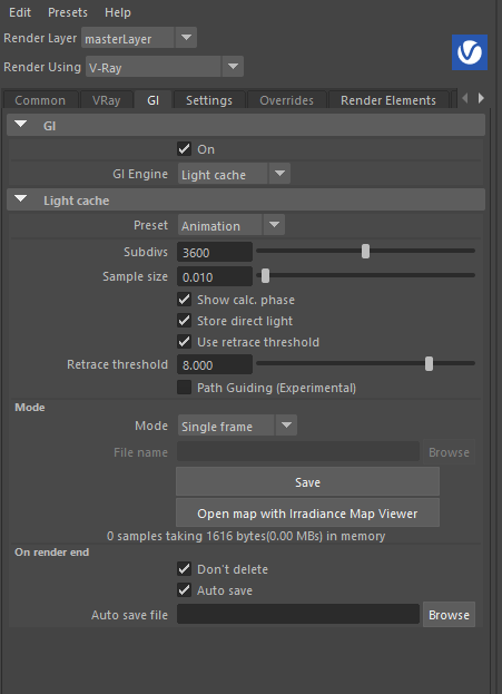

          Hey Martin,
          GPU LC Subdivs should be at 1500 for this scene, you don't need to go higher(Unless it is an interior scene, or if you are rendering at high resolution you will need to use a higher number, usually 3000 Max should work)
          You can try the Samples Limit at 5000, then 10000 if you want clean renders, with 0.005 noise threshold..
          About the flickering in the clouds, I have asked around. I will get back to you shortly

            Could you please try with BF/BF GI to see if it solves the flickering issue?
            Let me know if this works for you, we will need a scene to reproduce and investigate if this is about GPU LC
