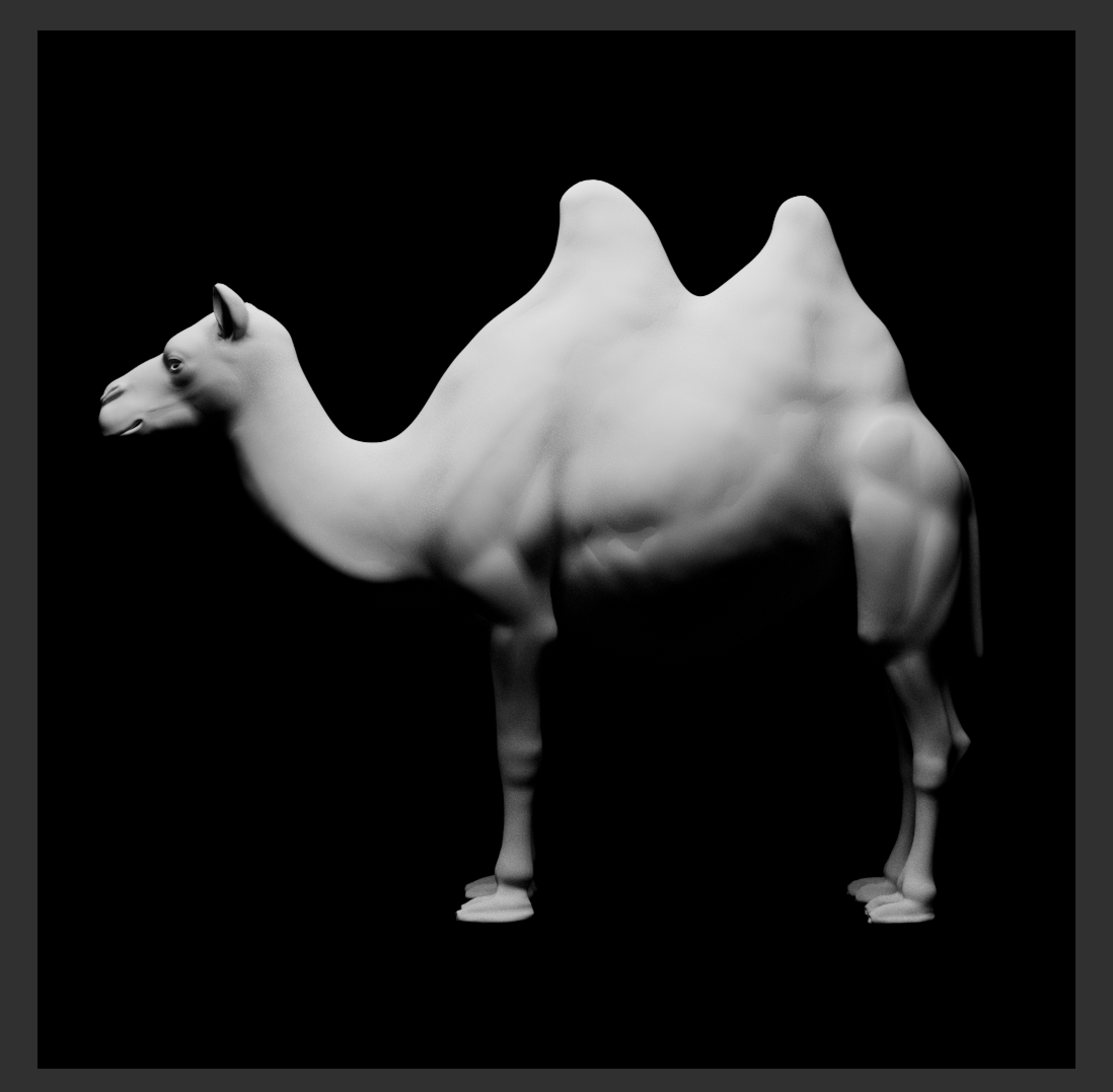

    I am trying to render some animal sculptures with V-Ray for the first time, and am using 32bit exr displacement maps that I extracted from zbrush. I setup a new lookdev project and scene, and was following the steps given to me in my previous post. For some reason the displacement is not showing. I created a new scene to test with Arnold quickly, and can confirm that the maps in fact work.
    In the following screenshot I have done the following:
    1. Import model
    2. Create VRayMtl
    3. Create VRay Rectangle Light
    4. Select model and create Subdivision, Subdivision and Displacement Control attributes
    5. Select model then Create > V-Ray > V-Ray Displacement > Apply Single Displacement
    6. Render
    Not sure what I have done wrong, but, the displacement isn't viewable. Using these same methods in another test file with tiling fabric textures, the displacement works. If I add a noise into the displacement attribute, it will work on this creature. It appears to not like this map for whatever reason.
    Any advice is greatly appreciated. Thank you very much!
