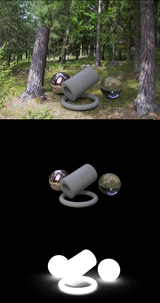

    Hello, I am coming from a mental ray and renderman background, now learning V-Ray and trying to get my head around camera projection as well as fast image based lighting/reflections.
    Short version; this is what I am trying to do:
    Long version:
    I have:
    * An image sequence (filmed material), locked off camera of an environment
    * A 3D object, made in Maya, which I want to place on the ground of the filmed material and integrate it into the environment
    Now, what I want is to place the 3D object in the filmed material and have it integrated. I'm now trying to figure out how to:
    1. Project the image sequence onto dummy geometry
    2. Create a environment dome around my scene
    Clarification:
    - I want to project the image sequence onto dummy geometry so that I can have the 3D object (e.g. a car) cast shadows/reflections on the dummy geometry (e.g. the ground). I'd also like the dummy geometry to be casting shadows and be reflected in the 3D geometry as well as be included in occlusion and GI calculations.
    - I would map an HDRI image onto the environment dome in order to cast reflections from it onto the 3D object with image based lighting as an option.
    Problems/Questions:
    I have now tried to create this workflow but I really can't figure out what the proper projection setup would be in V-Ray for Maya. Which shader should be used in conjunction with Maya's "projection" node?
    What node should ideally be used when creating a reflection dome which could also be used for lighting?
    Thanks in advance,

            I've done just as you guys suggested and it seems to work nicely; I'm projecting my backplate onto dummy geo using the VRayLightMtl, and wrapping all of that into the VRayMtlWrapper, which is applied onto the surfaces. Then I use the VRayLightDome to cast reflections as suggested as well. By adding in an additional light source(s), such as the VRayLightSphere, I get really nice shadows from the sun's direction.

            I also stumbled upon a problem when working with RT using this "workflow". It seems that RT can't handle the VRayMtlWrapper and/or VRayLightMtl correctly. Please see the attached image below. It's the same scene rendered first in RT and then using the standard V-Ray renderer. Build 14204 on Mac OS X Snow Leopard, Maya 2011 64-bit.
            Both renders above are from the same scene, I just switched between RT and the standard V-Ray renderer.
            As you can see, the alpha is wrong and the ground plane is visible in the rgb. Another issue I get is that the VRayLightSphere's shadows are not being shown at all.
            I tried to map the VRayLightMtl directly onto the ground plane and the shadows did still not show up on the ground from the VRayLightSphere. When I mapped a standard VRayMtl onto the ground, the shadows caused from the VRayLightSphere appeared correctly though.
            Could this be a bug or is it a limitation of the VRayLightMtl and VRayMtlWrapper?

              In fact, the VRayMtlWrapper can show reflections from the base material (there is a reflection slider to control their strength as well). So as a base material you can use a VRayBlendMtl material in additive mode where the base is your VRayLightMtl material, and the coat is a reflective material.
              In general the RT engine does not provide a very accurate preview of matte materials. Unfortunately this is not something that is easy to fix.
              Vlado
                The VRayLightMtl material does not compute any lighting, so it will not be able to show you any shadows.
                Vlado
                  I actually just tried this – didn't expect it to work – but it did!
                  A little slower to render ... but it works!
