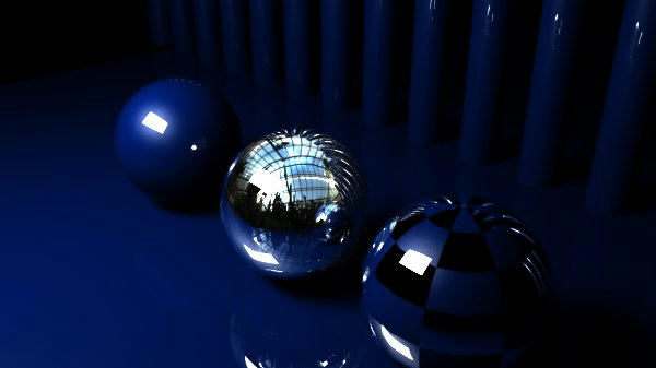

        hmm.. just double checked and for some reason it is not working:
        as you can see, I created 3 spheres....
        1. vraystd blue
        2. vraystd with env override
        3. vrayblend with 1 + 2
        I took a simple checker as mask.
        As you can see, the black parts on sphere 3 should be the chrome from sphere 2.
        The test image above shows not the RT engine - just the 2.0beta Standalone.
        www.bernhardrieder.com
        rieder.bernhard@gmail.com

                To get reflection in the third sphere you should set V-Ray Extra Attribute with Env. override option to the VRayBleandMtl as well.
                Right now the environment override affects only the "chrome" material.
                Zdravko Keremidchiev
                  yeah, but if I do so, I overwrite the env from the 1st sphere as well - and this is what I do NOT want !
                  so how to do this ?
                    Is this what you need?
                    Vlado
                      yes.. that's exactly what I want !
                      So the question is, how could you achieve it ?
                        Same as I told you - I added the override attributes to the chrome material, not to its shading group.
                        Vlado
