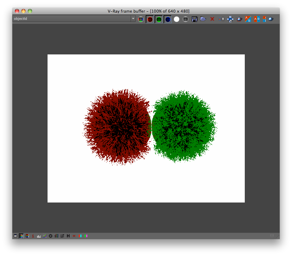

            From what I see, in the post-translate function you are changing the Maya scene, which is no use; you should be modifying the V-Ray scene instead. I'm attaching an example here: http://www.spot3d.com/vray/scenes/shave_matte.zip
            If you export a .vrscene file for the scene, you will see two plugins in it with type "hairVRayShader" - one has name "pSolidShape2@mesh4" and the other - "pSolidShape1@mesh3"; look for the respective "Node" plugins which reference those hair shaders as geometry. In this particular scene, they are "pSolidShape1@node" and "pSolidShape2@node" (you could walk the V-Ray scene to find the Node plugin that corresponds to a particular hairVRayShader plugin). Then you need to set the "objectID" parameter of the respective Node plugins, and voila - you get your mattes.
            This is my post-translate callback:
            Code:
            from vray.utils import *
            p=findByName("pSolidShape2@node")
            p[0].set("objectID", 1)
            q=findByName("pSolidShape1@node")
            q[0].set("objectID", 2)
            It might be a bit of a hassle to figure out the correct names though - the nodes just get some default names which are not immediately related to the Shave objects.
            Vlado

              I'll study your scene since I only get unmultipled objectid output rather than a clean multimatte result like yours (my matte aov remains black), should be trivial from now.
              Thanks again, have a good weekend !
              Tonio
                For this you need one (or more) multimatte element with the correct object IDs set for the red/green/blue components, like I have set it up in my scene.
                Vlado

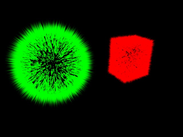

                  Really nice, it's now working like a charm.
                  I tried to find an "artist compliant" workflow, not sure it's the best way to control things but here's our method now : assign a material to a shave display group (fortunately it's the only way to get shave and render layers happy together), set a material id, create a matte RE and set ids accordingly.
                  The post-translate code will then transfer the material id to the associated shaveHairShader objectid, and we've come full cycle :
                  Code:
                  from vray.utils import findByName
                  def postTranslate():
                      nodes = findByName("pSolidShape*@node")
                      for node in nodes:
                          if node.has("material") and node.has("objectID"):
                              mat = node.get("material")
                              if mat.has("material_id_number"):
                                  node.set("objectID", int(mat.get("material_id_number")))
                  Thanks again for your kind help Vlado !
                  Tonio
