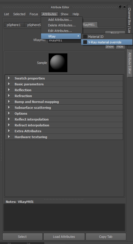

          Probably you saw it here:
ID:	846764Click image for larger version
            bah exactly ! Now I just have to figure out a way to use it with disp. I'm bit rusty with it atm hehe.
            Thanks all !
              Create two identical Vray Materials with different shading groups - one with displacement and one without.
              Assign material with displacement to your object - and add VrayOverride node - attach the material without displacement to GI override slot.
