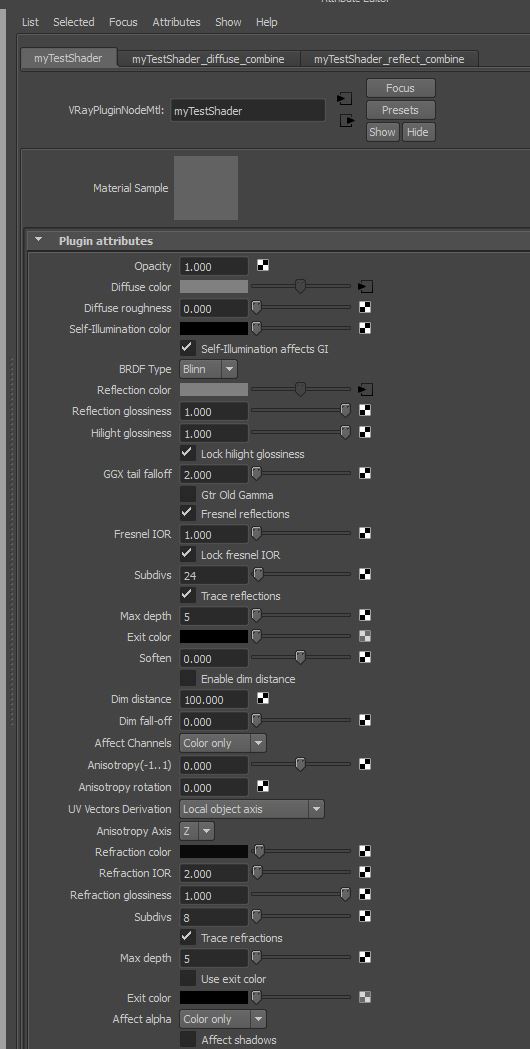

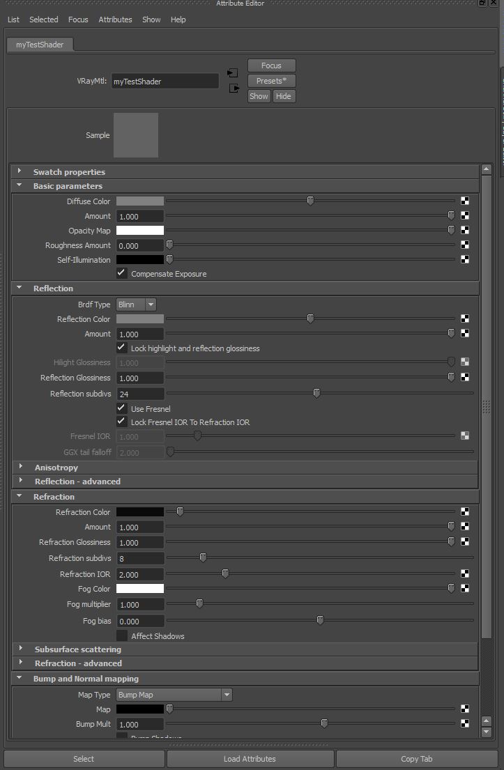

6. But I personally would like the VrayPluginNodeMtl to be a normal Maya VrayMTL. (I don't know if there is an easy way to do this, so if anybody has a good idea?). So for now I thought of writing a converter that converts this VrayPluginNodeMTL to a Maya VrayMTL.
In the basis the script checks the attributes of the VrayPluginNodeMtl and creates a new VrayMTL and puts those values in the correct corresponding attribute slots.
(It also automatically creates a correct linear workflow for all the necessary inputs / swatches. And removes unnecessary vrayPlugin nodes to get to most clean shader network. Removes Filtering from bitmaps. Stuff like that.)
7. Now when I Execute the script I'm left with a normal clean VrayMTL.
8. But here is the problem, @ step 5. There are 9 Attributes that are not exported from 3DsMax. In to the VrayPluginNodeMtl, So the script is also not able to transfer them to my new VrayMTL.

If there is anyone that can try this on their system, and see if they do receive these 9 Attributes. When sending over Vray Materials from Max to Maya.
Or if it's a bug? (The only thing you need to do, is adjust the values of these attributes to something that isn't the default and export the vray scene and import it in Maya and see if the value you just entered is being send over)
