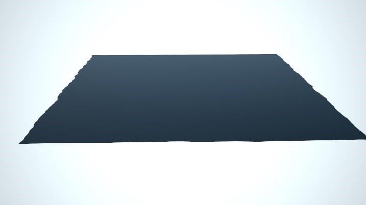

            Phoenix Ocean shader will not work..
            And I´ve no idea why.
            Found the sample scene here:
            http://forums.chaosgroup.com/showthr...=phoenix+ocean
            Load it and render with the "A-result" (no waves)
            Increase the Disp Amount to 10/-5 and get the "B-result" (all amplitute seems to work only horizontal)

            What is wrong? Please help to get the correct result...
            Thanks, Jörg
            (Win7, Maya 2015, Vray 3.3.02 - the last official build)

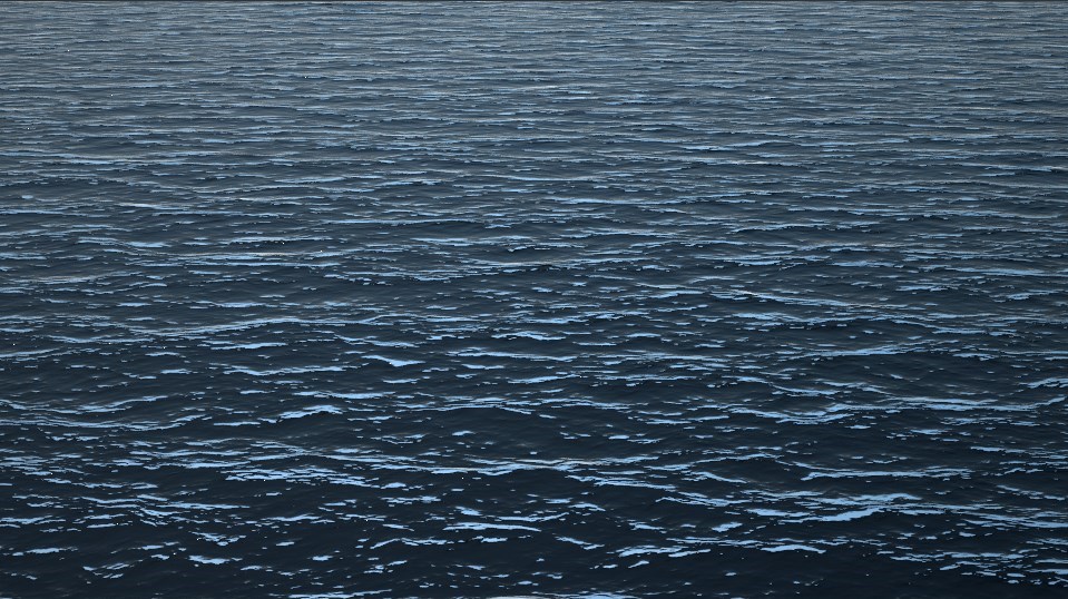

                  Try using Vector Displacement (absolute) mode for Displacement type. As for the horizontal issue you can change that with the Velcoh value of the PhxShaderOceanTex.
                  Zdravko Keremidchiev | chaos.com
                    hi Zdravko, that helps for the first. (image_A)

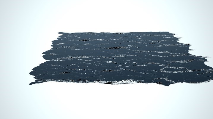

                    But when I scale the plane up to 10 (need much more space) then I get... (image_B)
                    First, the waves becomes a complete other look - it´s a 3dPlacement!!! and should be the same look, only bigger space!?
                    Second... and I get ugly black and brightBlue parts...

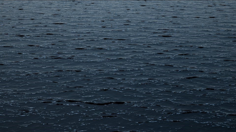

                    When I deactivate "View depentent" in the render tab, I get this result... (image_C)
                    The ugly black parts dissapears, but much more brightBlue parts appears... (image_D)
                    ...and it has nothing to do with the reflections!
                    Please give me some hints, how I can archive a bigger ocean surface.

                      How did you scale the plane? Try using ChannelBox instead. Here is an example scene: http://ftp.chaosgroup.com/support/phxoceantex1.ma
                      Also please keep in mind that the PhxShaderOceanTex texture options in Maya have different names. In example Velcoh correspond to Velocity coherence: http://docs.chaosgroup.com/display/P...enixFDOceanTex

                        hi Zdravko, thanks for the hint.
                        To scale the plane in the channelBox makes the job.
                        To scale the border edges do the job too.
                        Thanks for the sample scene.
                        Jörg
