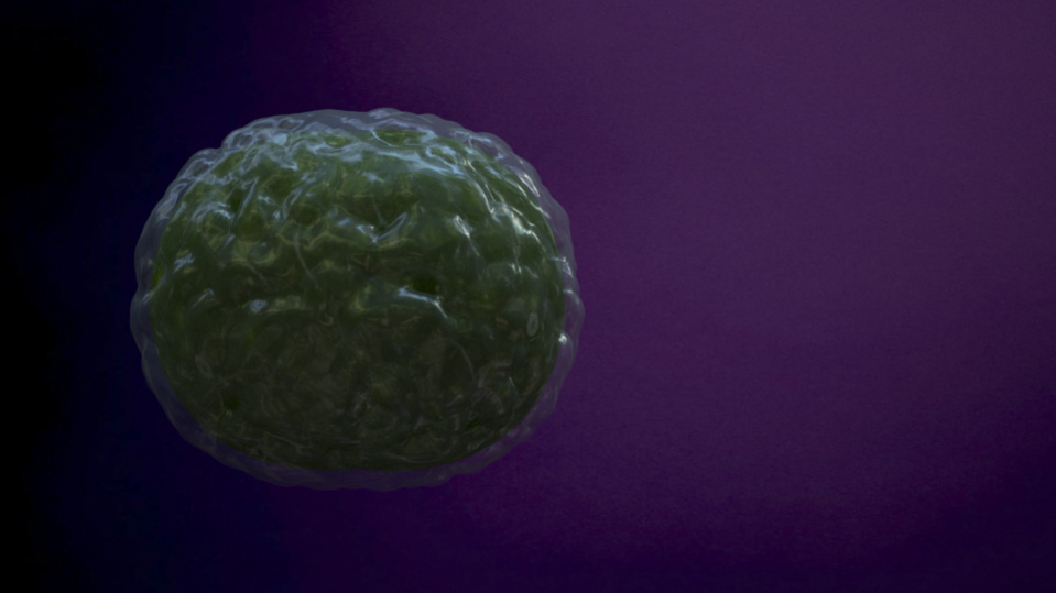

    I've emitted particles (bound to a VRayMetaball) from two spheres, which are initially overlapped since I want them to emulate a cell division. Attached three frames.
    As you can see, at frame 981, that is when one of the two spheres is moving away from the mother cell, the particles surrounding it move slower than the sphere itself, then for a few frames, I see a piece of surface without particles on it. In other words, particles follow the attached surface, but move slower. Spheres are goals for the particles. I've set this script at creation:

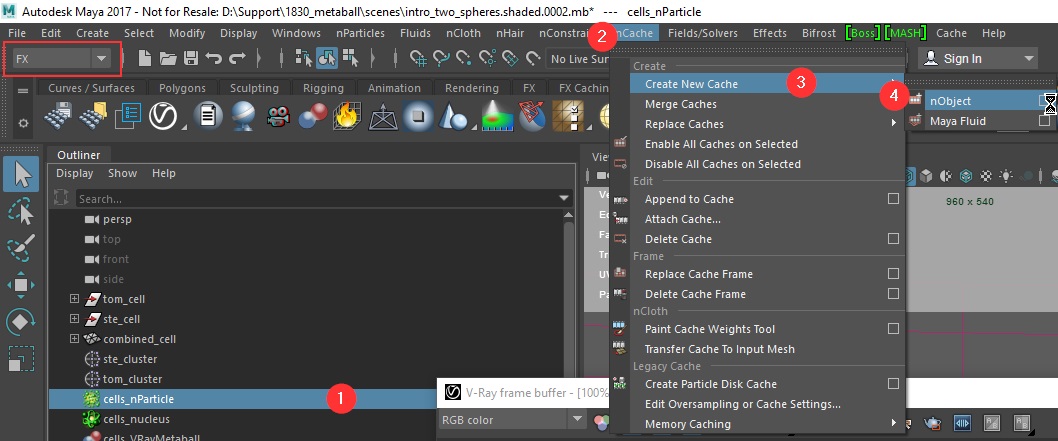

          OK I think we figured it out, it looks like it is necessary to have particles caches to disk in order to render a sequence properly.
          I just did that and I can confirm that everything works fine.
          To cache the particles select them and go to FX menu, nCache>Create New Cache>Nobject
          Select cache dir and cache name, hit Apply and wait for the caches to be stored to the hard drive.
          Once completed you should be able to render the frames without that defect.

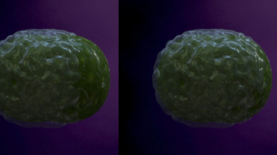

                caching seems to partially solve (attenuate the problem). Look at the stills. Left (old still) - right (new still after caching).
ID:	867183Click image for larger version
ID:	867184Click image for larger version
ID:	867185Click image for larger version
ID:	867186Click image for larger version
                There should be still something missing...

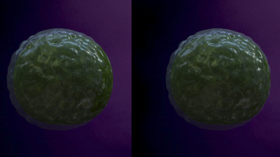

                  Hi Guys,
                  finally it looks like I made it.
                  After a long trip, I've learned that when particles are attached to surfaces that move very quickly, you must increase the over samples (FX combo box. nCache > Edit Oversampling or Cache settings). It suffices for me to increase to 2.
                  In addition, under the "Solver attributes" of the nucleus node, I've set the Timing Output to "Subframe". (not sure if this was essential)
                  Under the Dynamic Propeerties of the particle node, I've lowered the "conserve" attribute to 0 (maybe boring, but it was necessary).
                  That's all
