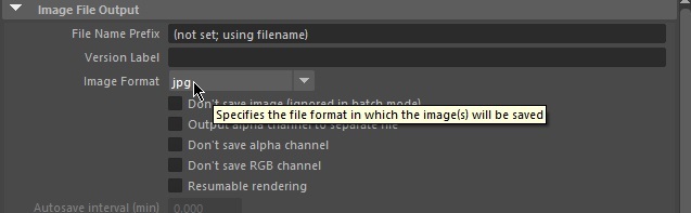

    Do you often save images manually from the VFB? Wouldn't be a better option to specify file type and name from Image File Output options and save the file automatically? Click image for larger version

      That's not the same Svetlozar, is not for animation, I only work with still images from the frame buffer to show to production designer, I just can't find a way to change it...also PNGs take quite a while to save , Jpgs are very fast, this slows me down quite a bit , on top with all the other Maya glitches.
