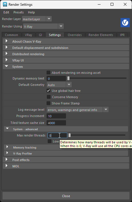

    Open the "System - advanced" slot.
    Then modify the values you need here

            I would not agree that killing renders has "never been a problem before" with Vray, but in any case setting a thread limit and using less than 100 percent of available RAM for renders should be all that you need to do. This is rendering 101.
