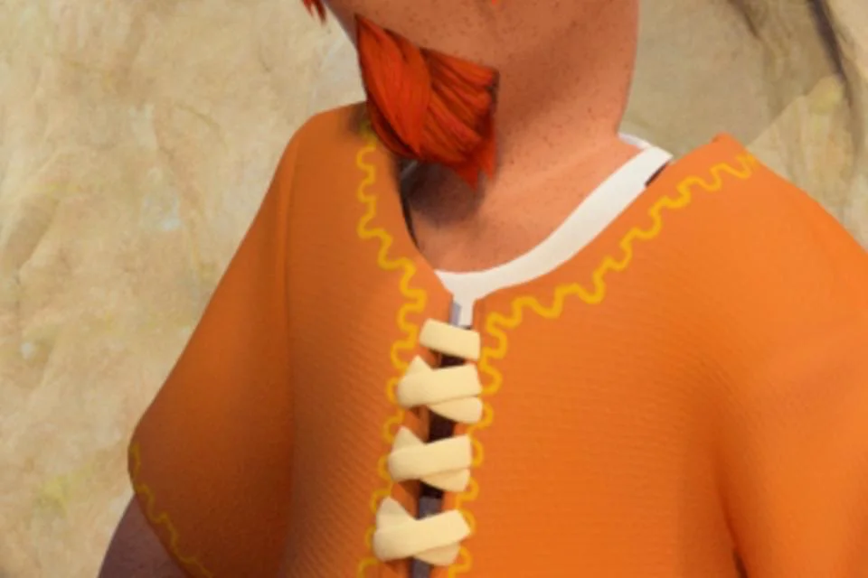

    Any thoughts on this strange issue?
    It looks as if the texture coordinates are getting lost in translation. Using rendertime subdivs, 2 levels.
    2.2 Maya 2010 Winx64
    We are using maya geoCaches, then sending .vrscene files to the farm.

      No, it seems intermittent. Sometimes a translation to .vrscene is fine for the entire shot, sometimes it's broken. It does seem isolated to this piece of geometry though. I'll do a sanity check on the model.
        We dug a little deeper into the renderfarm logs and found the error. We missed it before since it only showed up for certain frames.
        [2012/Mar/2|01:16:45] warning: Some faces of Seq_05_Shot_03_Finaling_008__overshirtShape1Deform ed@mesh1865@subdivGeometry were removed because they were duplicates of other faces.
        Is this caused by something in the scene or an error during translation?
        Thanks.
          It is caused sometimes by a particular configuration of the vertices for the faces; it does not mean there is an error somewhere in the scene or the translation. We did however have a bug with UVs when this happened. This is already fixed for the latest stable/nightly builds.
