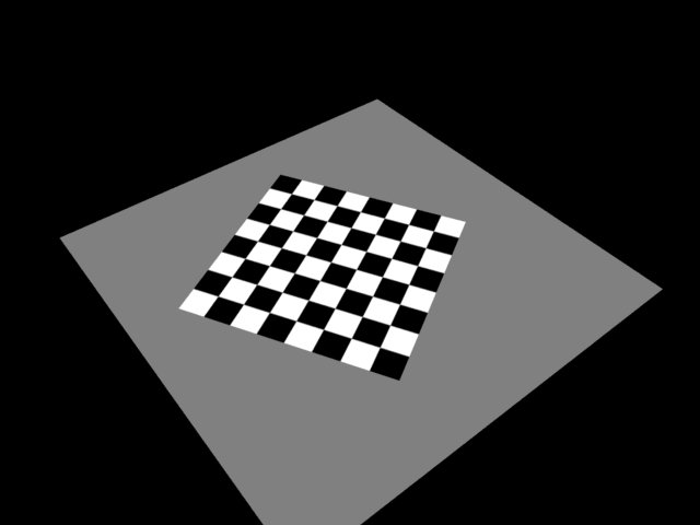

    Hi,
    I am trying to use a maya projection node's outTransparency. When I render in Maya renderer I get the expected result but when I render with vray I see the the outTransparency is not correct - it's just a copy of the outAlpha.
    This is a major problem for us since it prohibits the use of layered texture projections using transparency which we need for a job currently in progress. Is this an issue you are aware of and can it be fixed quickly?
    Thanks,
    Philip
    Please see attached maya file.
    Example renders:
    Maya render:
    Vray render:
    Thanks for the pointer; yes, we should be able to will fix it quickly.
    Vlado
      Hi,
      This issue should be fixed in the next nightly build.
      Please test and report if there are any more problems.
      /Teodor
      V-Ray developer
