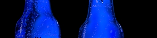

    Hi,
    I am having an issue where my normal map is affecting the refraction of my shader. The normal map just adds additional drops to the bottle through a bump normal shader. Bottle on the left has the normal map and unfortuantly I am unable to share the sceneClick image for larger version
    Never mind I fixed the problem, the neutral values of the normal map where not .5,.5,1 .
