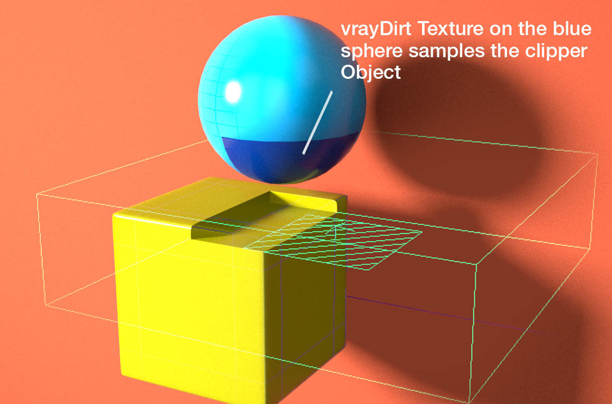

      Here is a screenshot that illustrates the problem. I have to uncheck primary visibility
      and all other render parameters on the clipper mesh and have to enable "work with transparency"
      on the dirtTexture to solve this. In a more complex scene this took a while to pinpoint.

        Ah, now I get it Sorry about that. Now I know what you mean. Well, I think it is doing what it is supposed to, at least at first glance, but I might be wrong of course..
        Looking at the scene now, it seems to be behaving like you would expect it too when the clipper_geo object is excluded from being affected by the dirt. I've simply added clipper_geo to the "result affect" set (and unticked "as inclusive set") and it is no longer occluded.
        Have you tried this? Could it work for your case?

          Now I am confused,
          I thought the clipper mesh would be invisible for all objects in
          the scene, be it reflection, refraction, shadows etc..
          So I was surprised that it is visible to the vrayDirt Texture.
            Hmm, it might not be the most intuitive thing, I agree. I'll forward this to the devs for consideration.
