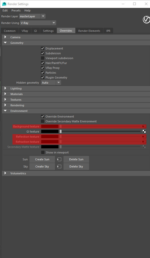

    Hi, some strange things happen if i use enviroment texture in render setting.
    I cannot use camera image plane, cause vray doesnt handle it like a background, so camera mapping is applied. Also i cannot get in render element the backgroyund layer for post.
    So my workaround is to put my background image in render settings like enviroment, and in my placeenviroment texture set to "Screen".
    With these settings, i get my background without camera mapping aplied, and i get it as background layer in render element. Eveything fine, since vray starts to do strnge things with this workaround.
    Refraction gets dark like image attached.
    Other example, just solid ground gets semitransparent, dont know why.

            You need to enable Affect background option in the Color mapping roll-out to match the background intensity of the reflection and refraction one. Also, The region exr issue is on our To do list.

              But just too quick. In fact, as i mentioned before, my whole workaround is just to get the background out of the camera mapping. If i check this option, my background gets camera mapping applied and has no sense. Is just simple, i have a background where i dont need to get anything, no GI, no light, no depth, no camera mapping applied, nothing, just be visible and affect reflections and refractions. As you can see in the new image, the background now is dark.
              Also as you can notice the semitransparent issue in the opaque material keep also "Affect Background" is checked.
                The issue comes from the fact that you need to match the background to the refl and refraction, where you have applied color correction and you don't want to apply this correction to the background image. Any particular reason you don't want to check Affect background option. If you want to increase the brightness of the image you can change its color gain value or use HDRI image instead.
                Also, you can still see the trees through that object because it has reflections and you have overridden the reflections with that image set to screen projection. To work around that you can set separate PlaceEnvTex node with spherical mapping for the reflection and refraction override slot.

                    I understand, but in case that you want to keep the background image as it is: you either should not use any color correction or keep the same workflow and color correct the reflection and refraction alone to match the background image brightness.
