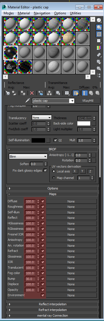

    In 3dsmax you can control the percentage of any map it would be great if we could do the same in maya!!!

      You can use the blendcolor node, assign the map to one of the slots, a color to the other and the blend attribute to act as the percentage. There's another thread somewhere about it.

        There was a heated discussion about this a long time ago; the overall consensus was to leave it like that because the native Maya shaders work in this way. As others suggested, you can use a blend node to do the same thing.

          This is what I was referring to (screen grab from 3dsmax)

          I will try the blend node, thanks!
            But how to plug blendcolors node into reflection glossiness slot?
            It's really not the same thing at all. :/

              Connect the outputR attribute of the blendColors node to the reflectionGlossiness input of the VRayMtl node?

                woooo there it is. Thanks again vlado!
                  Most of the Maya textures also have color/alpha gain.
