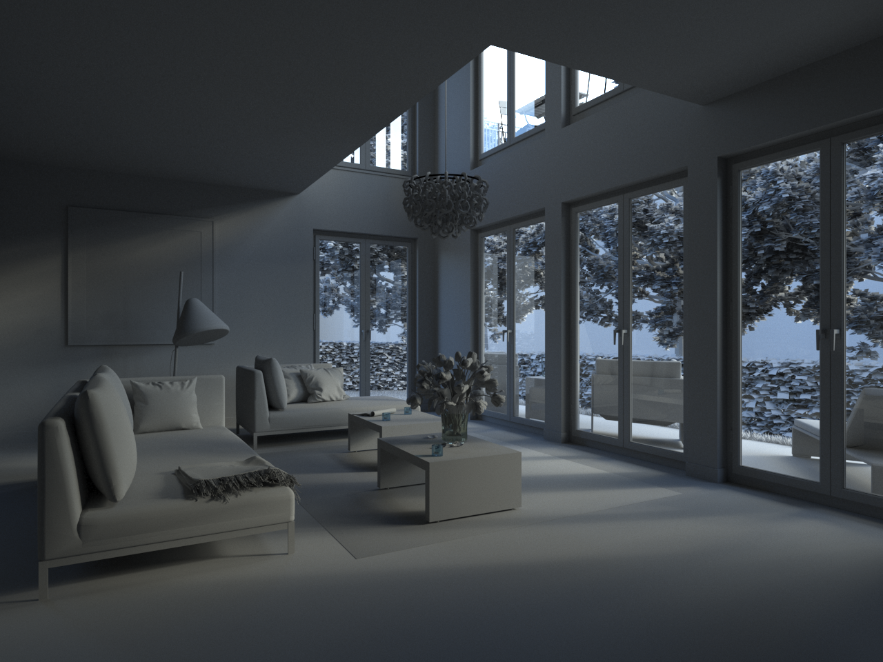

    Hi everyone,
    i have a problem getting a clean interior rendering with VRay. Attached is a Diffuse Direct Light channel that shows the problem, lots of grain in the shadows; strange enough nothing on the floor. Its obviously not that much in the rendering, but since i add contrast to the rendering its still visible. The grain comes from the hdri that is attached to a dome light, rendering is IC/LC with adaptive sampling, threshold is already at 0,002. Rendertime is 9 hours on my computer, Modos renderer delivers a clean picture in 3 hours, just as a comparison. I also tested different scenes and different hdris, but its all the same.
    I can make the subdivision setting for the dome light higher to get a clean rendering, but than the rendertime gets insane; the same happens when i use the hdri in a modo environment and use the EIS settings. Rendering brute force makes things a bit better, but rendertime gets slower too.
    Sooo, any tips for getting a clean rendering are welcome.

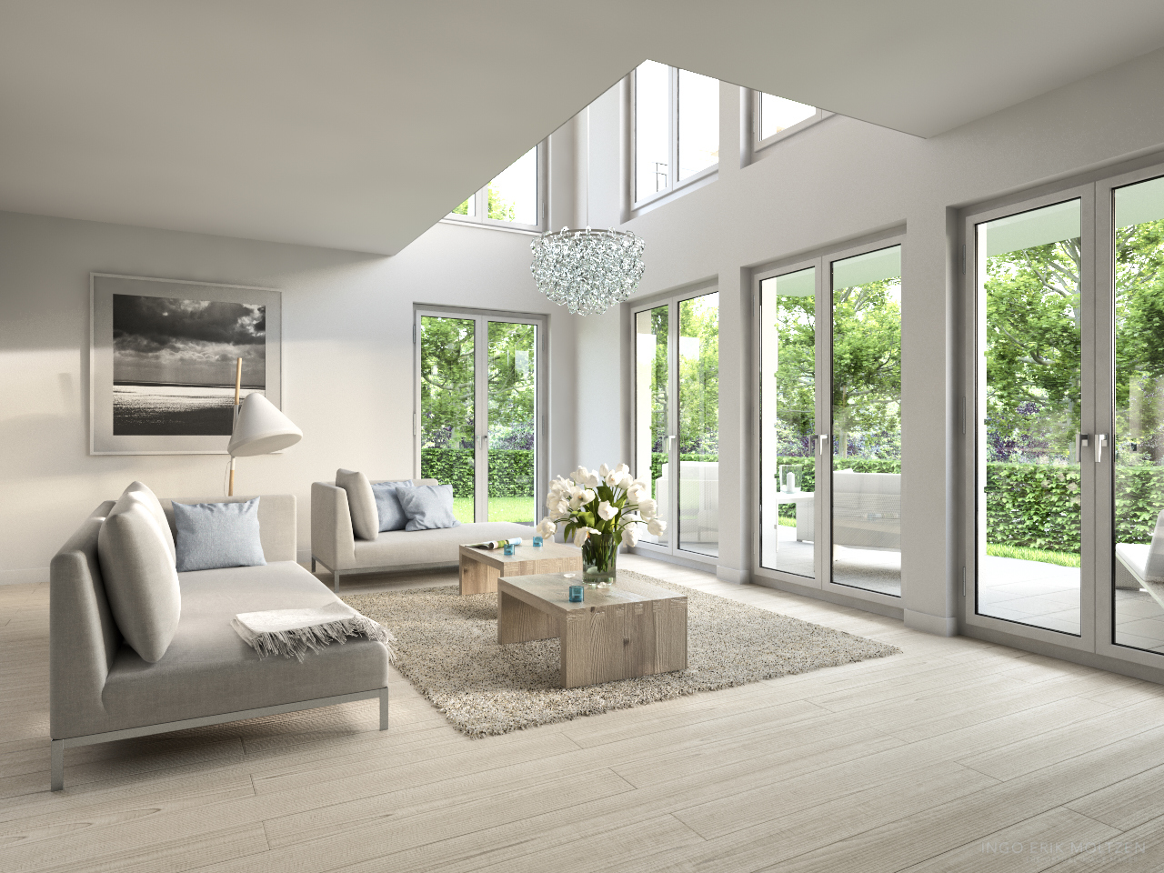

    Here is the rendering :
Name:	Godeffroy i 26.jpg
    www.ingoerikmoltzen.com
      to avoid misunderstandings, its not the overall noise but its the biten edges i like to smooth out. Attached is again a diffuse direct light channel, this time its at print resolution.

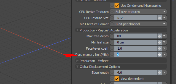

          I will try your settings but so far i haven't found "dynamic memory limit" nor a "sample rate render element", do you use a newer version ?
            Check out my screenshot for sample rate and dynamic memory limit.
