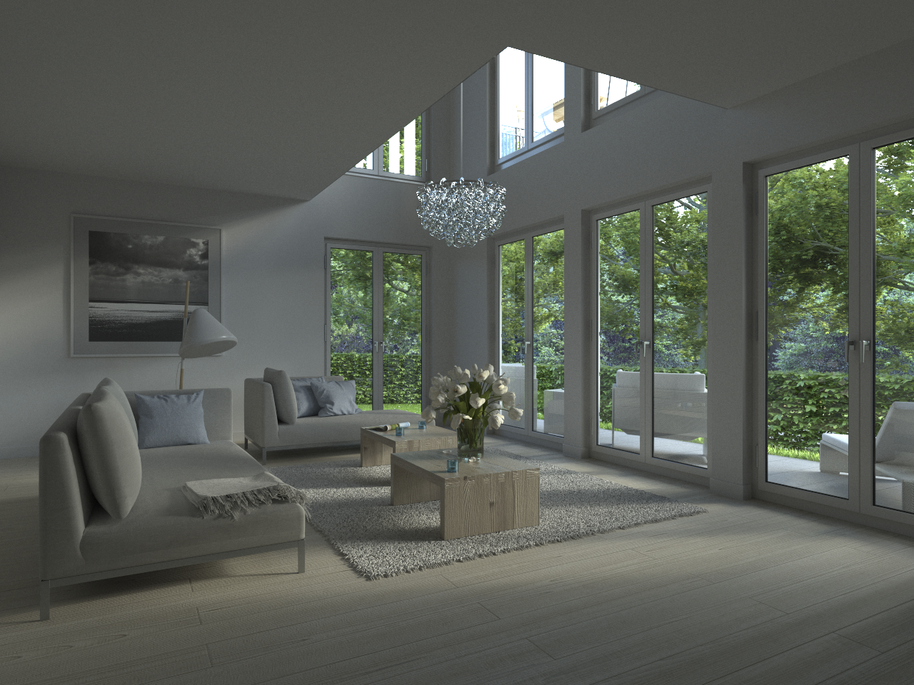

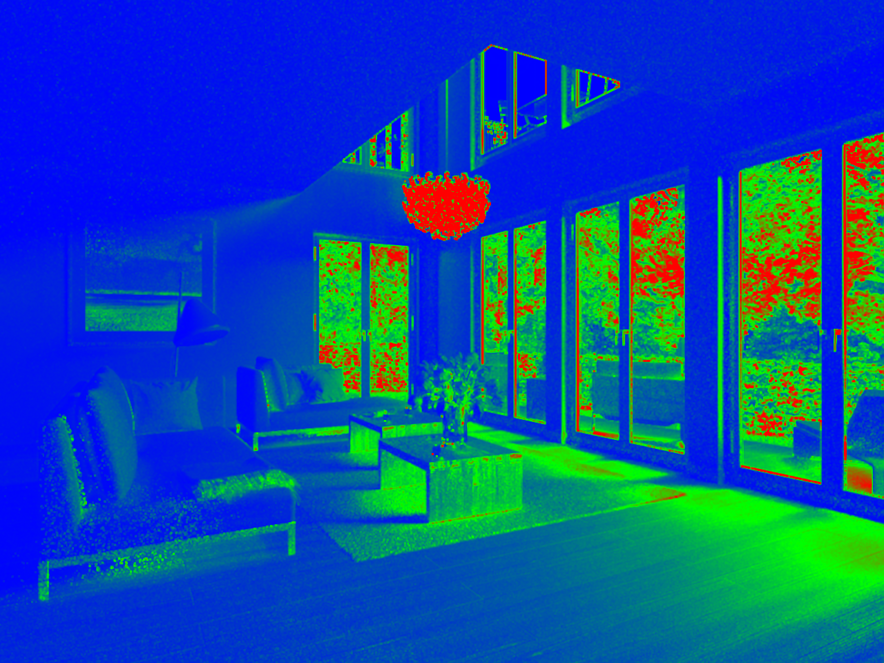

          So, here is the next one, Brute Force with Muhammeds settings (adaptive Sampler 16,1,32,0.00 and Portals, BUT NO DomeLight, just normal environment. Walls and ceiling have now a stucco imagemap to see how it works with the noise, rendertime is nearly 11 hours.
          Dear Santa from ChaosGroup, please add an EIS to DomeLights that is as good as Modos EIS I still wonder why i get DomeLight noise on the walls and the ceiling, but not on the floor.
Name:	Godeffroy i 32_10h34m BF_thr008_Portals_no DomeLight.png
ID:	1020239Click image for larger version
Name:	Godeffroy i 32_10h34m BF_thr008_Portals_no DomeLight-Shaded_AA_Samples.png

              So if i use HDRI on a DomeLight (means EIS) and Area Lights in the windows the noise from the DomeLight has less contrast and looks a bit better, but rendertimes get longer. Portals act as a direct light, they just sample the incoming colors from the GI, kind of a textured Area Light.
              When i avoid direct light and bruteforce rendering i get a completly noisefree picture, that means an Irradiance rendering and hdri only in environment, without domelight. But of course the contrast from the hdri lighting is low and its hard to get clean shadows.
              www.ingoerikmoltzen.com

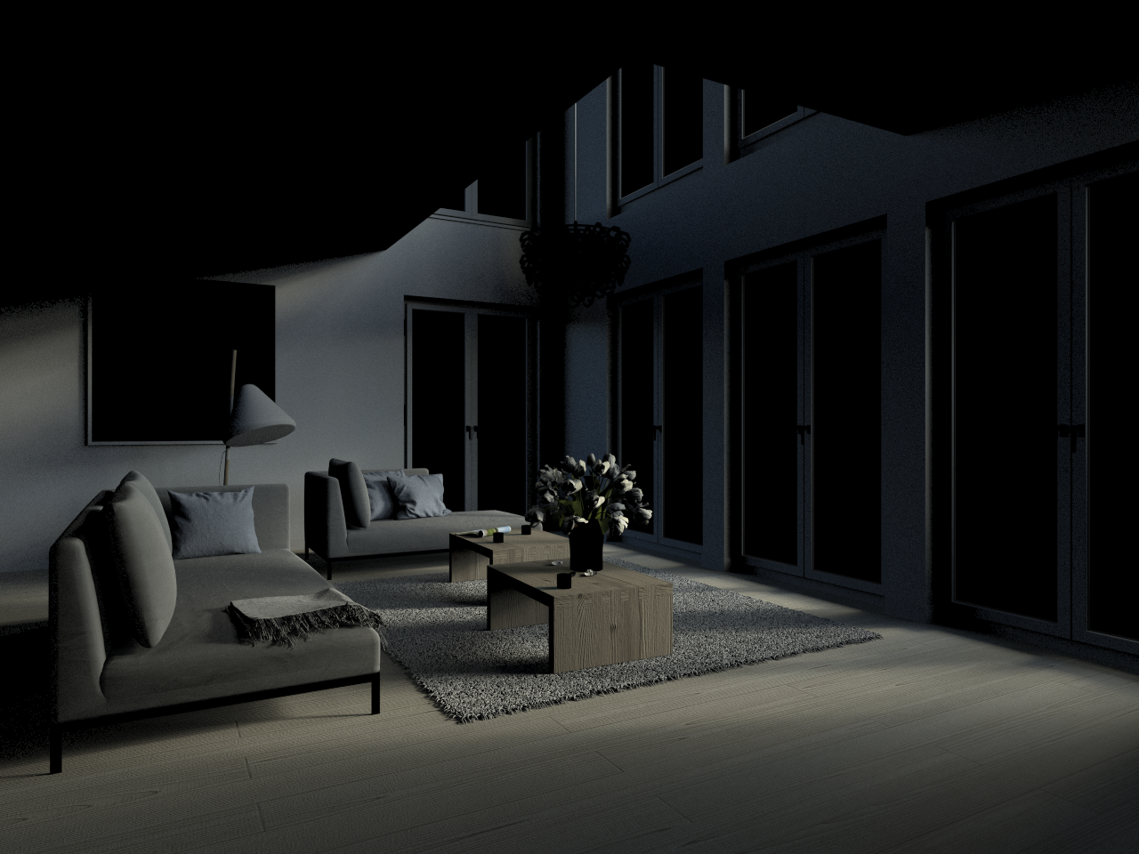

                        So here are the indirect and direct diffuse shading RE from the above rendering.
Name:	interior Diffuse_Shading__Indirect.png
Name:	interior Diffuse_Shading__Direct.png

                          The problem is VRays direct light quality, here are two diffuse direct REs from the room lit only by area lights in windows, rendering is irradiance. One with the default 8 subdivs and one with 256 subdivs. Interesting is that the higher quality picture renders a bit faster.
ID:	1020286Click image for larger version

                            Okay, the last pictures, thanks for all the help. Brute Force with Muhammeds settings (adaptive Sampler 16,1,32,0.007 and Area Lights, environment as DomeLight), AreaLights and Environment have a subdiv of 16 instead of default 8. Walls and ceiling have a stucco imagemap again, rendertime is nearly 8 hours.
                            We got noise in the renders coming mostly from the Domelight+HDRI and of course the BruteForce renderings. We get some more noise from the exterior (replicated grass and hedges ... and the trees). Portals are not that useful, AreaLights help to clean up the noise a bit. So noisy BruteForce is easier to handle, especially when you put it on the renderfarm, Irradiance is faster but you get annoying noise on the walls on the right that needs a bit get clean. Comparsion to Modo its a bit difficult because i never used BruteForce, but Modos IC is faster, or cleaner, depending on the settings. I've got a clean IC in Modo in 5-6 hours, i got a rendering in VRay in 6 hours that has definitly still noise.
                            Keep in mind that this testscene has everything to slow down renderings, a fur carpet, a glass chandelier, replicated greenery outside through glass windows, and a HDRI for lighting.
Name:	Godeffroy i 33_7h41m BF thr007 area lights.png
ID:	1020383Click image for larger version
Name:	Godeffroy i 33_7h41m BF thr007 area lights-shaded aa samples.png
ID:	1020382Click image for larger version
Name:	Godeffroy i 33_7h41m BF thr007 area lights-shaded direct.png
