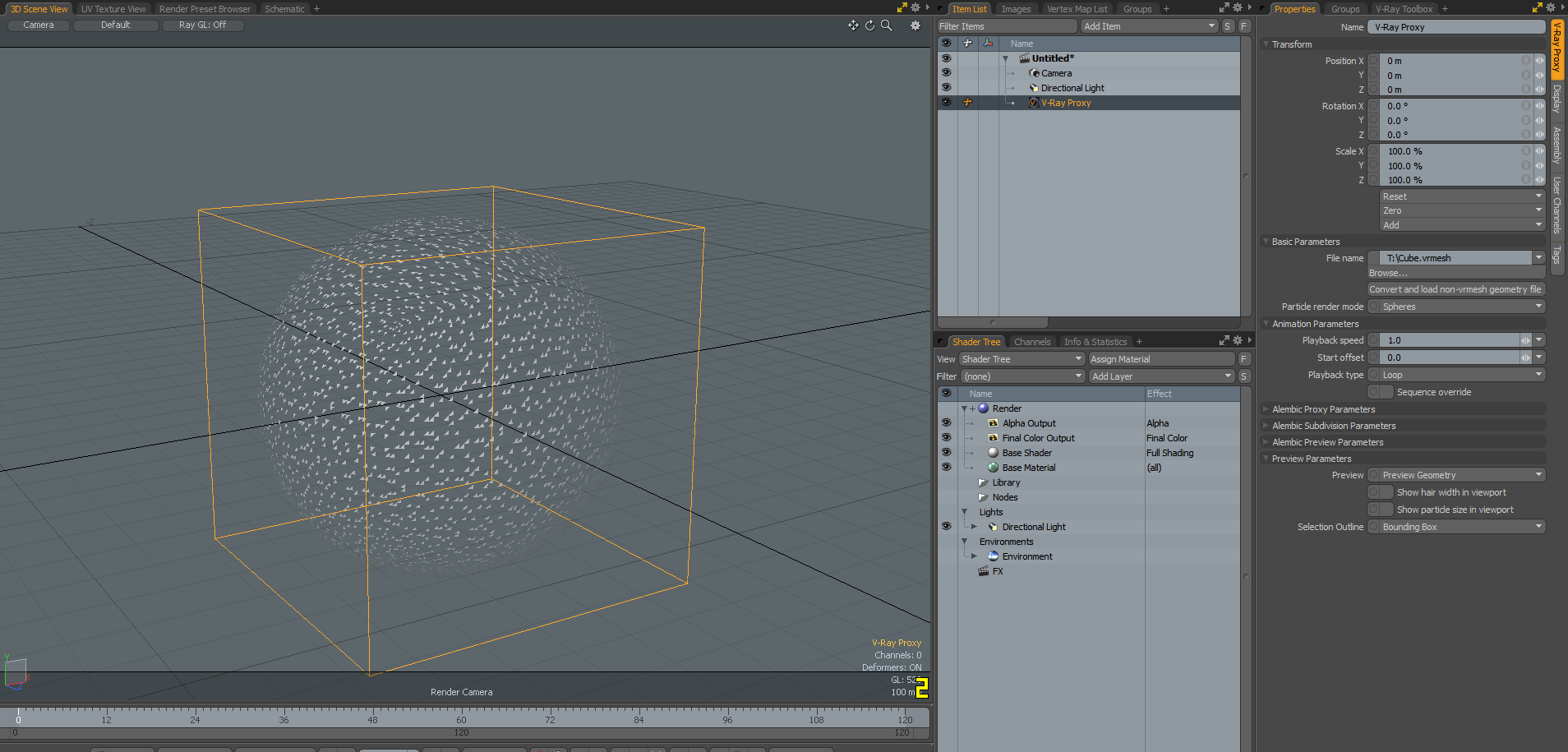

1. If the proxy was created from a non-subd mesh, its preview will be a bunch of disconnected triangles. Trying to select them using click selection can be a pain, since there is a lot of empty space between them. See attached screenshot.
Using paint selection works relatively ok in this case. Just paint across the proxy until it gets selected (i.e. you hit a polygon). Also you can switch the preview type to bounding box or voxel bounding boxes.
I will add the mesh simplification options for creating the vrmesh preview (in the Convert to V-Ray Proxy command). They create a connected mesh, which should work much better with click selection.
