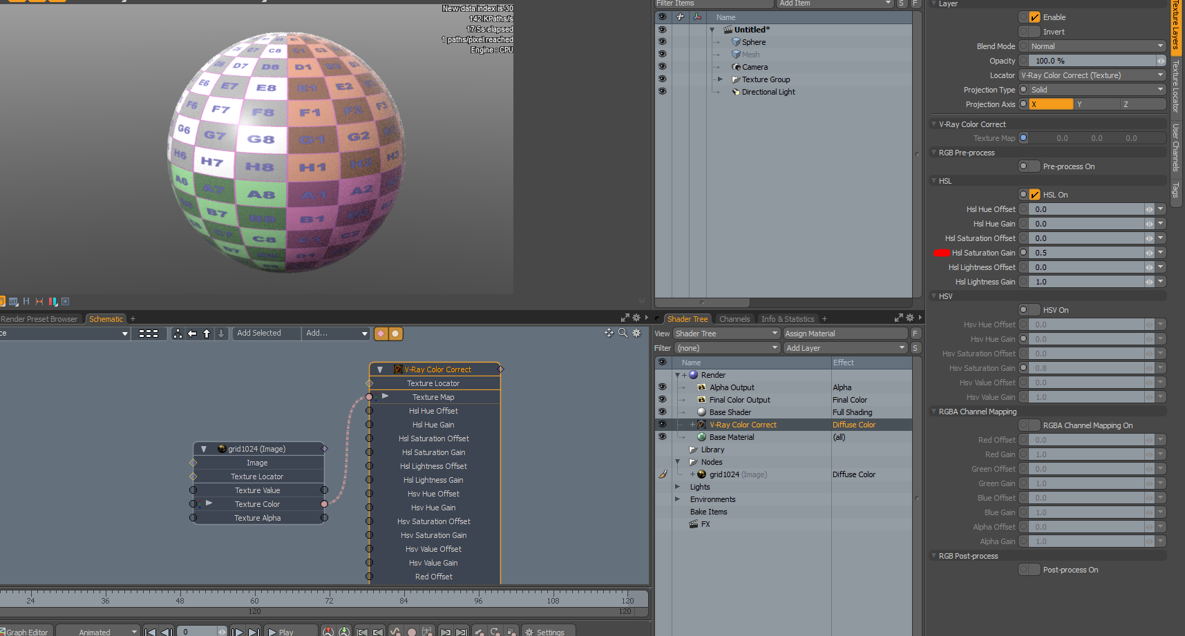

Do you think it would be possible that parenting a Color Correct / Color Correction to a layer ( as a layer mask ) automatically connect it to the parent ( make the parent layer as the Texture Source ) ? It's the behaviour of Modo's Process layer and it is very convenient for the scenes which don't use nodes for the materials. It saves a few clicks

Are you sure the process texture works like this ?
I think you put the process texture above another layer and it uses this other layer as input.
I plan to add this type of behavior (probably enabled with a check-box to preserve old scenes) to some of our textures at some point.
Oh yes in fact I was wrong, but you get it.
The idea is to bypass the use of schematic view to connect the texture layer to the CC layer, no matter how it's done. Great to see that you have already planned this.
