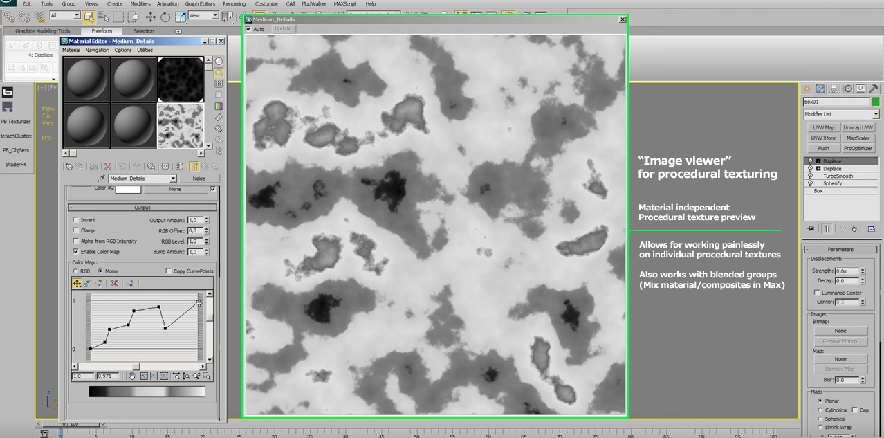

Is it at all technically possible to add a 2d "image viewer" for V-Ray procedurals to V-Ray for Modo that simply shows the current procedural being worked on regardless of what shading function it's being assigned to?
Something like the attached image from 3ds max.
