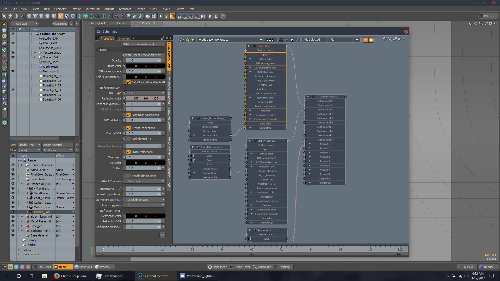

    Hi,
    After some testing,the best way really to get a realistic Carbon Fiber shader is using one normal map that is baked from real fibers geometry. So,just Frensel of 2.5 and the normal map that I baked in Modo So,there is no need to use maps for faking Anastropy..etc
    Here are the results

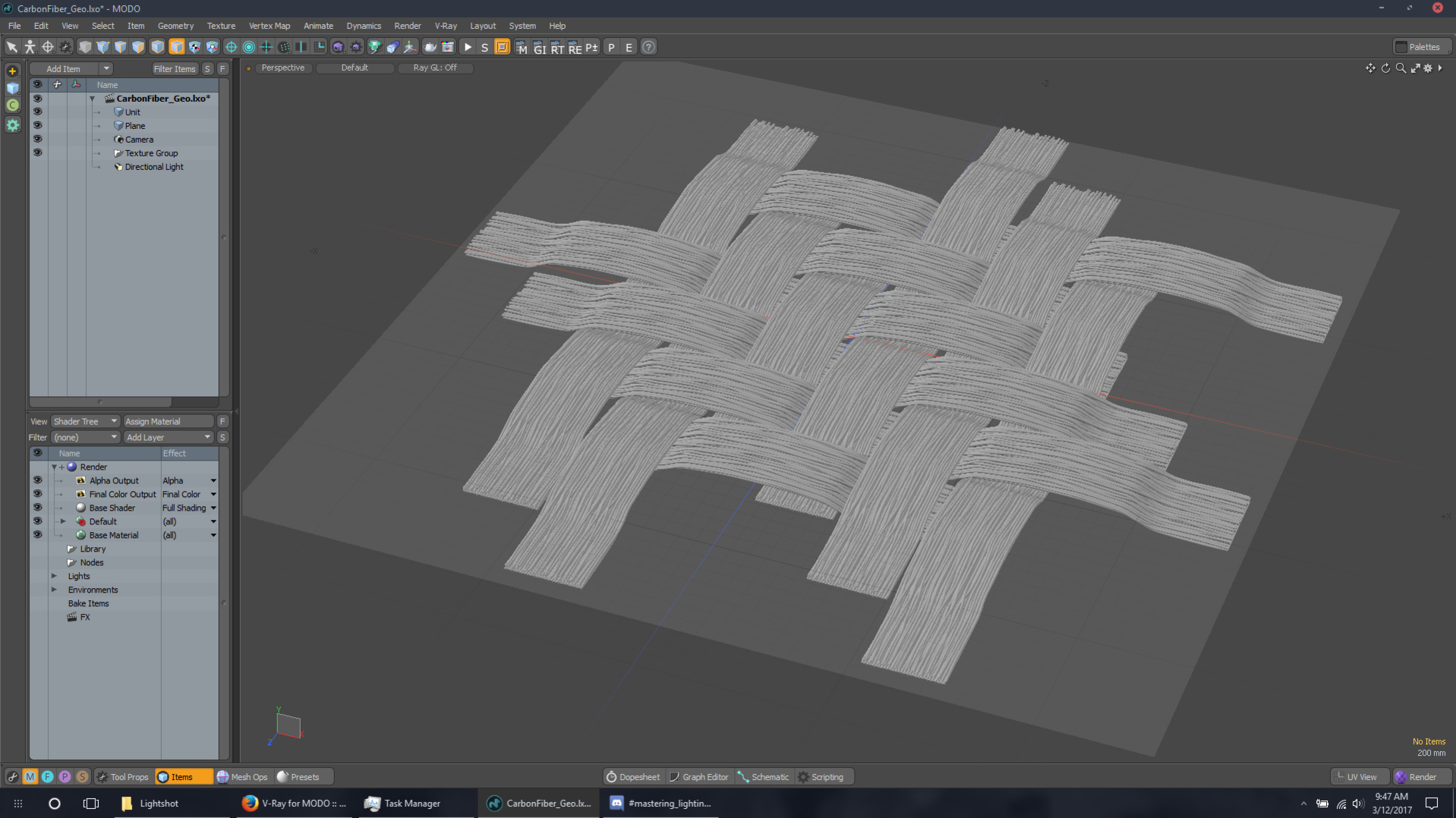

    And here is the geometry I used to bake the normal map in Modo,

                      Hello,
                      Here are 2 variations of the normal maps I baked, I uploaded 5k versions here.. the original baked maps were in 20k resolution, I still have them as well
                      You will be able to get a different look by changing the normal map multiplier
                      Best,
                      Muhammed
