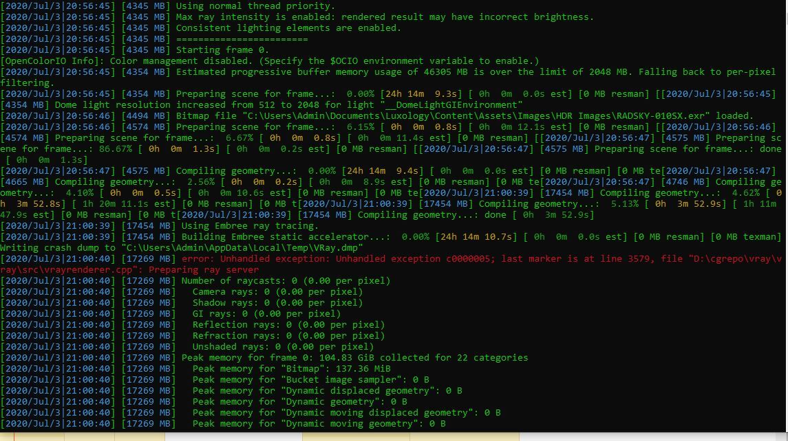

    I am trying to render a scene with the water material, and do see the effect I believe I need to render this with the cpu - when I try to do this either with RT or standalone, it starts as usual, but fails everytime. I can render the image at 4k. is this a lack of memory? I have 32 gigs of ram. this is the only error I see - Click image for larger version

        I am guessing this is an issue with running out of memory, since it happens when you increase the resolution.
        You can use the memory tracker to figure out what exactly is eating up the memory.
        Render at the lower resolution and check Modo's Event Log or the V-Ray Standalone console.
        Look for the "Peak memory for" lines and they will tell you what's eating up the RAM.

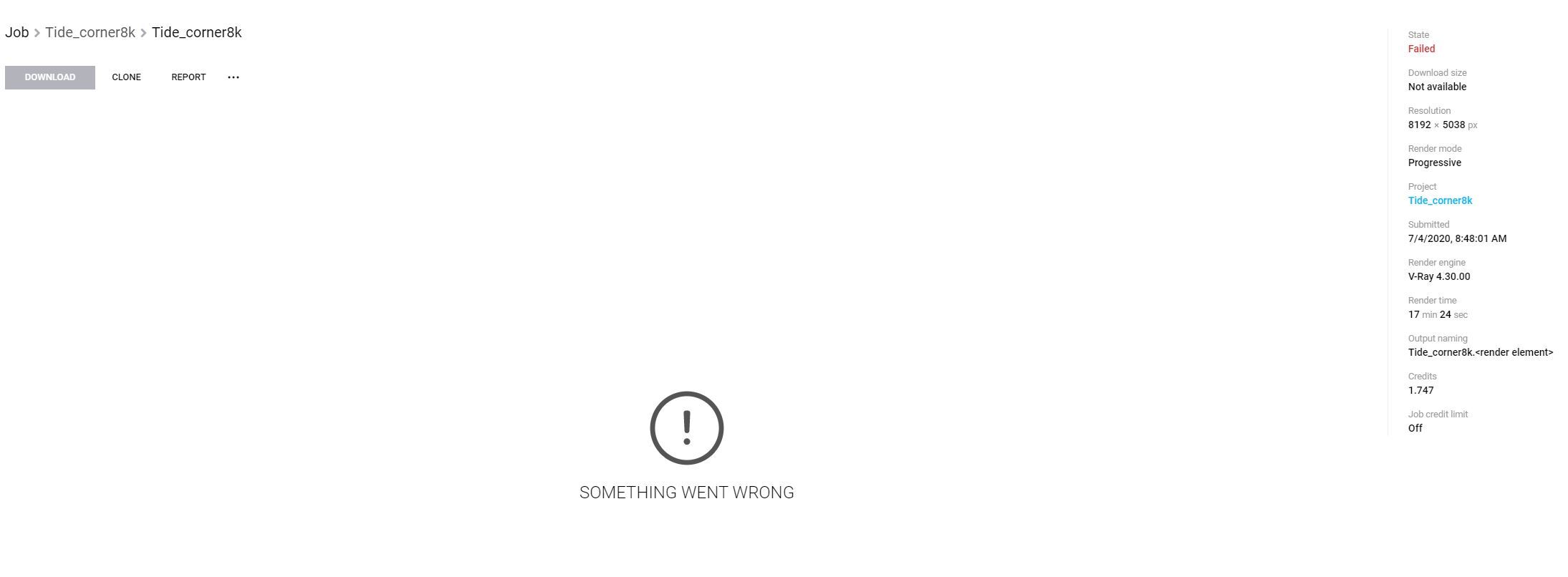

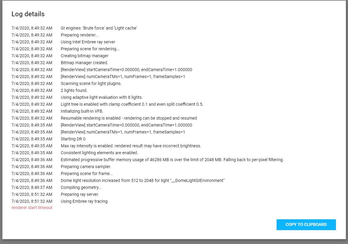

          ok thank you! I wonder though, why would I get the failure in the cloud? it worked at 4k, failed at 8k, same as on my machine.
            Yes, that's strange, those machines have a lot of RAM.
            Maybe you can report the issue through the V-Ray cloud platform and they will be able to rerun the job and debug it for the exact reason.
