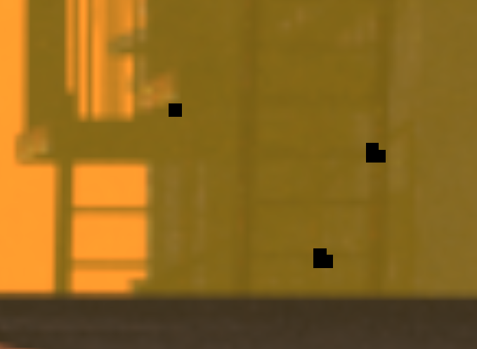

    When ever I render a scene with atmospheric effects and output my image in layers, such as diffuse total and atmospheric I get black pixel random in the image. All render settings are default, so I wonder why?
    The atmospheric output is correct, its just diffuse having these issues. Sample below

    Thank you for the post. Could please check if this is NaN pixel (use VFB pixel information button - "i") negative pixel value or there're missing buckets? Share the result with us here.

      Its NANs. when layering exr outputs they burn in negativ. Clamping the low value helped on some layers. Transparency output was mostly hit by NANs, even in areas where the image was just black.
      The Diffuse Direct and Diffuse Indirect worked. So I layered both to simulate the Diffuse Total output.
