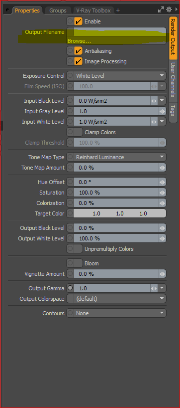

Thank you for the post. You have two options to save 16-bit images as PNG or Tiff :
1. As use "Save as" option from Render Output
2. In the latest build # 26644 20160812 you're able to use new options in Vray tab - "Render with V-Ray" and "Render animation with V-Ray". You can download it from "V-Ray 3.0 for Modo nightly / nightlies".

Howdy Tioem,
It seems fine to me. You can use both methods as well. You can select image format from Render Element output as well. After render is done the easiest way to verify the file is to open the file's properties with right click and check the details. The file supposed to be 64 bit (16-bit x RGBA).
