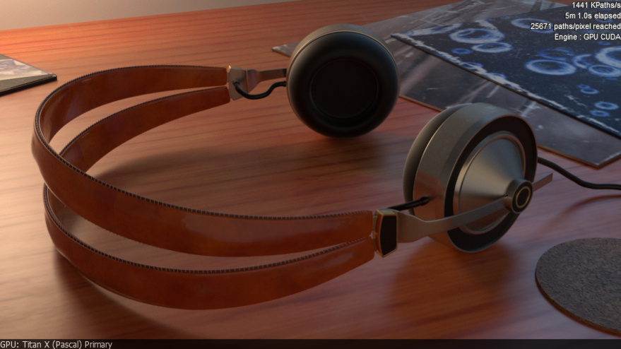

              Extra figures. Attached is rendered from the same file as Barend's. Notably my Primary and secondary Pascal cards have a 26s difference. Previous test I did the Primary card was faster and the secondary was slower, so it isn't always consistent. PCI-e lanes for both Pascal cards are x16 and the Maxwell x8. I know SLI doesn't play a roll in GPU rendering but is there a disadvantage of having the SLI connector on (for the Pascal cards)?
Name:	Titan X Maxwell.jpg
ID:	863685Click image for larger version
Name:	Titan X Pascal Primary.jpg
ID:	863686Click image for larger version
Name:	Titan X Pascal Secondary.jpg
ID:	863687Click image for larger version
