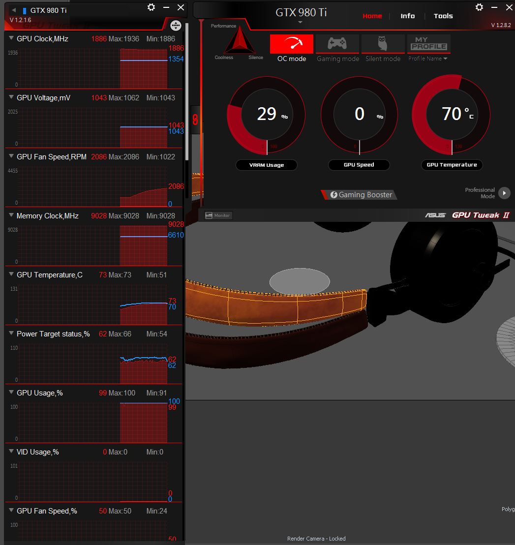

          I have run the same test scene with both the 1080 and 980Ti together. If I look at the screenshot attached, the blue is the 980Ti and the red the 1080 speeds.
          If I make the right assumptions, the 1080 is faster in all areas but the cores are less...I assume that will be the reason for the slower renders?

            Core # = linear speed up for CUDA?
            That is not the case. The 1080 has many speed advantages. It's actually harder to say "that's a fast GPU" with confidence than it is a CPU IMHO.
            If it were the case, you'd see the recent octane betas and other tests with the 1080 slower- but it's not. Many octane tests put the stock 1070 at just 6% less performance than the 980ti too. With the right 1070 you can easily overtake a stock 980ti when over clocking- and not by huge amounts. So the 1080 should be doing better in RT than what you're getting.
            https://render.otoy.com/forum/viewtopic.php?f=9&t=56108&start=10
            Do you have octane or the benchmark demo? You might want to download it and see how your card compares. That will help you narrow down if it's something with RT, or your setups/card. I look forward to seeing what other scenes end up doing too than just the headphones one.
            I suspect things will change soon once GT uses the CUDA 8 kit to bundle but that's just my guess. Some say it will...some say it wont. If not then something is up for sure either with the scene or some other way RT is using the 1080 (or not).
