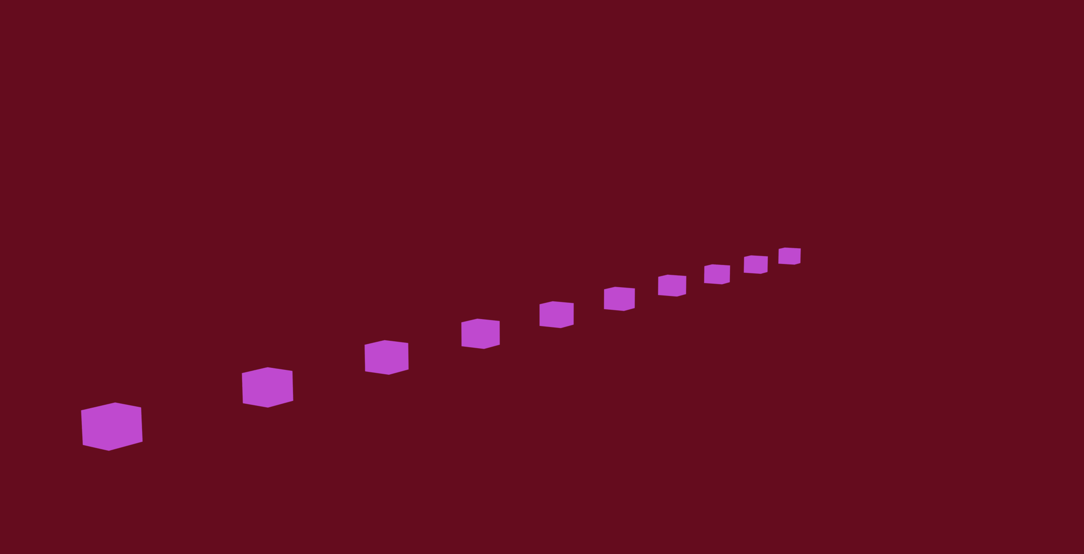

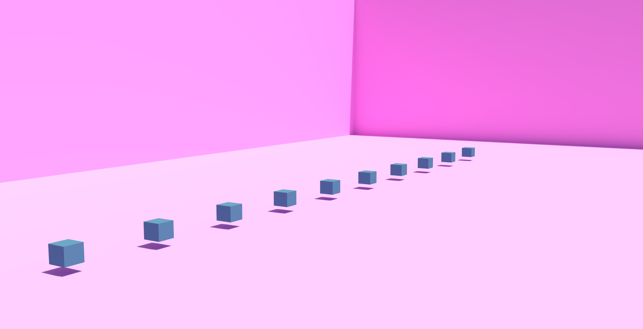

    Enabling volumetric environment in a scene makes the material random color pass more or less unusable for compositing/post work in photoshop by effectively gradating the color of the material in the random color pass. Here is a simple scenario with just two generic materials, one for the surround and one for the boxes arrayed away from the camera. With no environment the materials display as defined single colors, but with the environment enabled they are displayed as gradated tones. Is there a way to tell vray to ignore atmosphere in the material pass?

        Seems like this is a limitation of the Environment Fog.
        2 possible workarounds in this case.
        1. Use the ZDepth render element (basically adding fog in the post)- this will create a render element that displays the distance from an object to the camera with a grayscale image. Please see the link below for additional information
        https://docs.chaos.com/display/VRHINO/ZDepth
        The benefits of using this over the Environment Fog are faster render times, easier compositing(the fog will be separated from other render elements), and repurposing the same render element as a focus mask.
        2. Use masks without antialiasing like Material ID number, Object ID, Render ID, or MiltiMatte Materials/Objects in non AA mode
