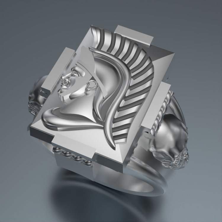

ID:	1174721 I want to have the ring not reflect the color of the floor, so I created a wrapper of the silver material and enabled ignore objects in secondary thinking it would ignore the floor object and its reflections. Click image for larger version

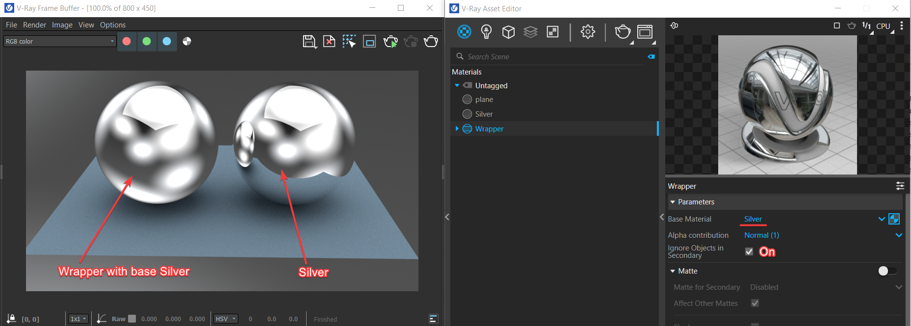

    You are on a right way to achieve your aim. You can try the following options:
    • To be sure you applied the right material to the right object you can first select an object and then right click on your Wrapper material in the Asset Editor and click on the "Apply to Selection" option.
    • If you still prefer to apply your material to all objects in a layer using the option "Apply To Layer", then first make sure you did not apply any materials on individually selected objects. Then apply the material to the exact layer you want.
    Here is an example:
    I hope this will help. If you have questions do not hesitate to ask them.

        Here is another way to achieve a result with no reflections from the surface (floor) to the object (your ring). As the surface is the one that you do not want to be reflected anywhere, its secondary rays could be overwritten.
        1. Create a new Generic material and set its Opacity to 0. This material is now invisible, so rename it with "Invisible_mtl".
        2. Select your material applied to the floor.
        3. Add an Override attribute from "Add Attribute" option.
        4. For Reflection and GI select the Invisible_mlt.
        As a result, the silver object will not reflect the floor.
